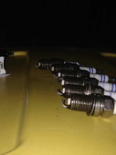

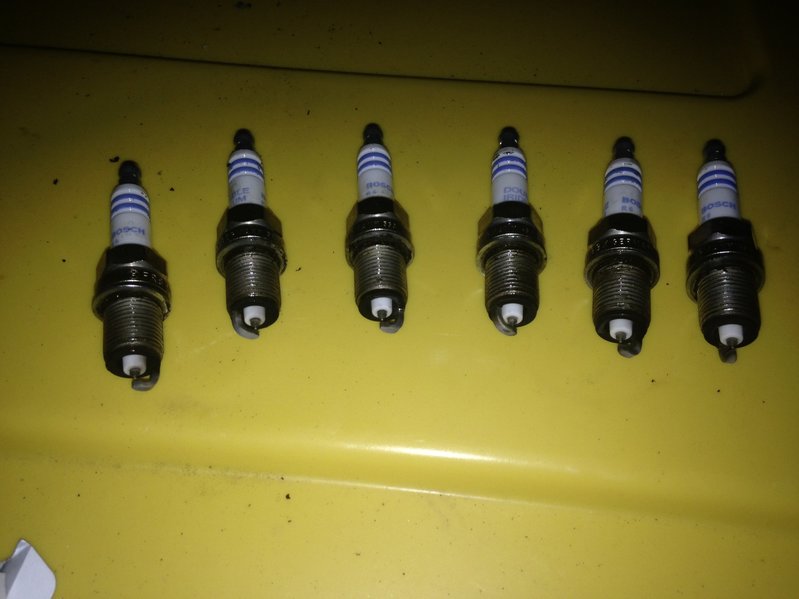

    First off, get rid of those shit Bosch plugs and put in oem Denso or NGK BKR5EKB-11, don't use iridium of any brand unless you have a supercharger. These engines are picky about the plugs you use, countless owners have learned their lesson when not using the right plugs.

    I will change out the plugs, I was a little weary about running them; although it was a recommendation.

    I really think the plugs will help tremendously, I use there NGK's, they come pregapped to .44 which they are supposed to be for the 5vzfe, I've never seen the gaps off, I usually check, they come well packaged with a protective sleeve. Many say it's a good idea to check them, but they are a dual electrode plug, if you gap them and the 2 electrodes aren't perfectly spaced, if 1 is closer, it will fire like a single electrode because electricity always takes the path of least resistance. If you insist of gapping them, you need to be careful how you check the gap, the opening between the tip and the electrode is curved so using a proper tool is important, you measure the gap at it's even circumference, not flat across the tip to the outermost tips of the curve on the electrode
    This video is for single electrode plugs, but the tool recommendation and technique works best if you want to gap dual electrode plugs

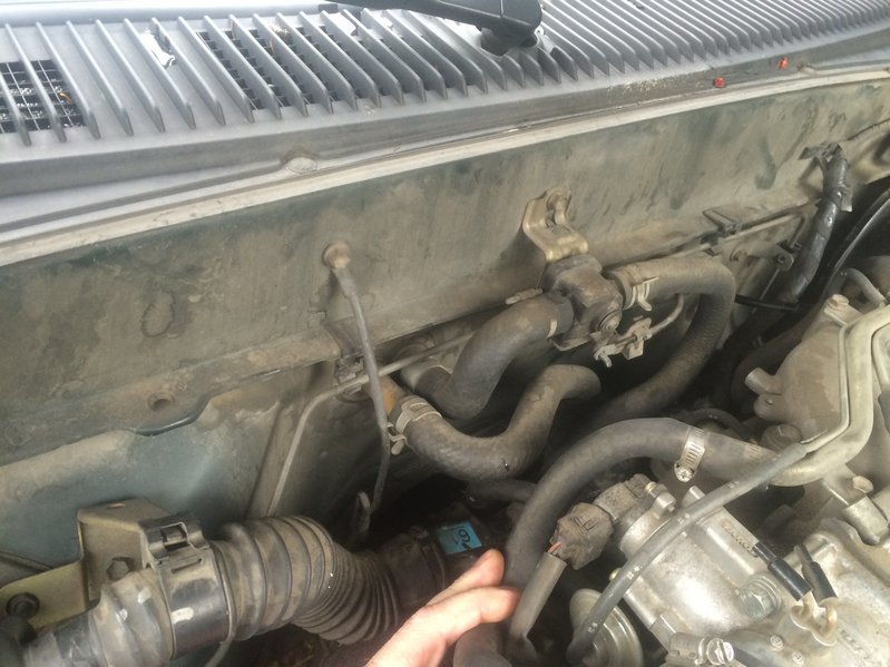

    I may be missing a couple of parts & hoses. I guess the PO found a better use for them.
    I ran the truck late last night and it ran the best it has since I have owned it.
    I ran it this morning and it ran great for about 20 miles.
    Then it started having the same symptons with losing power and just not running great.
    I have also lost my heat & it will blow a faint fog through the vents every now & then.
    Can someone tell me what this part is? I have been trying to find a decent diagram on it.

    What the hell?!??! That's your heater controls and the inlet and outlet to the heater core, that's totally fucked, I'd be pissed, I'm pissed for you, no wonder you don't have heat, he must've bypassed your heater core or something, that is some bullshit!!!

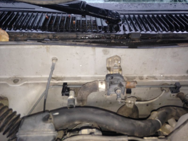

    image.jpg Look a little different? The hoses come off the two pipes on the back of the engine, one of them the coolant bypass pipe you probable saw when you were doing the knock sensors. I bet that asshole just put a loop of hose between the two.
    What a fucking jerk, No doubt the heater core is toast and he jimmy'd it to sell it. Heater cores are pretty cheep, not really any need to get oem Toyota on that, just get a parts house one. Changing them isn't too bad, I did the last one in under 4 hours. Don't pull off the top of the dash like Toyota says, just go through where the radio and all that shit is. That sucks man, I feel for you.

    Thanks for the picture. I have been looking for one because I cant figure out how to run it.
