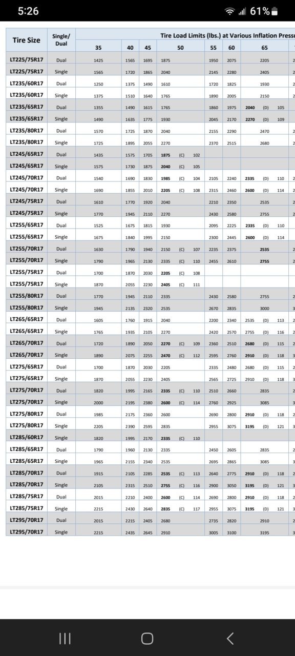

    Stock size is P245/75r16 at 30 psi. Not sure what the original load rating is, probably around 110, whatever the third gen SR5 has is more than likely the same. Let me know. I might drop a few more PSI, didn't know I could run these so close to the stock recommendation. I'm still really interested in doing a chalk test though. I went through a small puddle coming into the driveway last night when it was at 42 psi and just from the water tire print you could tell it was over inflated which is what sent me down this rabbit hole in the first place.
  15. May 5, 2023 at 4:02 PM
    #35
    splitbolt
    splitbolt Voodoo Witch Doctor
    Mar 7, 2010
    #32761
    7,858
    NW Arkansas
    2016 TRD OFFROAD DCSB MGM
    Okay...
    For a 2012, in that size, it was a 109 load rating.
    A P245/75/16/109; @ 30 psi, gives a load value of 2,105 lbs. If it was a euro-metric 245/75/16/109, @ 30 psi, that gives a load value of 1,973 lbs.
    Folks tend to conflate P-metric and euro-metric, or make no distinction. I just wanted to show the difference; and it is significant. If one doesn't enter the correct info in a calculator like you used, the answer will be incorrect.
    I'm pretty sure yours came with a P-metric, so we will calculate from there.
    When LTs are used on a truck or SUV, they are not de-reated like P-metric and euro-metric tires. So, LTs only require a psi to get a load value of 2,105÷1.1=1,913 lbs.
    Here's the chart for a LT285/70/17...
    @ 35 psi you have a load value of 2,105 lbs.
    @40 psi you have a load value of 2,315 lbs.
    So from that...
    5 psi=210 lbs or 1psi=42 lbs
    @ 31 psi you would be at 2,105-(42x4)=1,937 lbs load value.

    Thank you so much for taking the time to write this up. I'll read it over and see where I want to go with it. Probably drop a few psi honestly but yeah thanks for giving me what I need to make an informed decision.

    Here's a pdf link to Toyo's load inflation guide...
    It'll explain the how and why of all that stuff I posted...and the p-metric and euro-metric charts I omitted.
