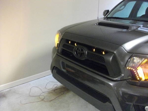

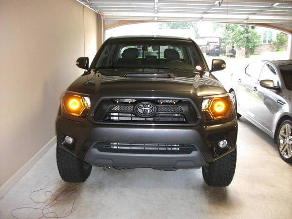

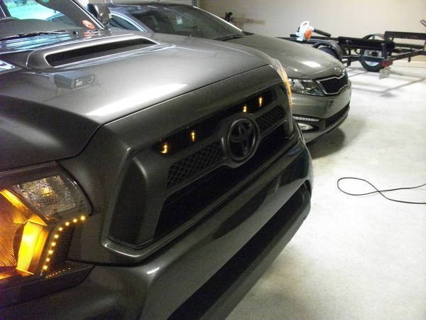

    I have amber LED strips mounted on the grille facing toward the radiator. I suppose the same effect could be accomplished with something like trailer marker lights, but I wanted the installation to be stealthy. Besides, the LEDs draw almost no current and I simply spliced them into the parking light circuit.
    Later, when I get time, I am going to hook these and the "eyebrow" lights up to a circuit that will also turn on with the dome light so I can turn them on and off with the factory alarm remote. The lights in the hood scoop will also follow a pre-selected "Knight Rider" scan pattern when I unlock the doors.

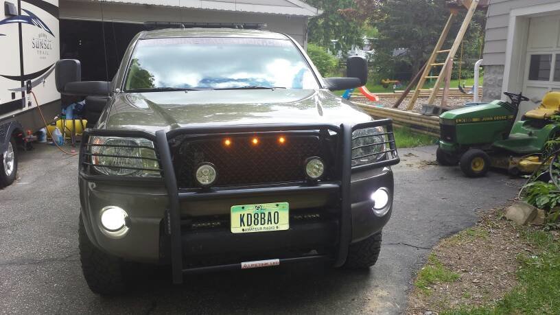

    Got a new grille. Replaced old lights, spread them out a bit. Went with lifetime led eagle eye lights
    And a shot with all my white lights
    Lifetime LED lights:
    H4 headlights
    Bazooka 25 watt on push bar
    6" cree lower valence
    3 1.5 watt eagle eyes in grille
    Feniex industries:
    Cannon led hide away in fog
    Avatar warning bar ( titan module ) on roof

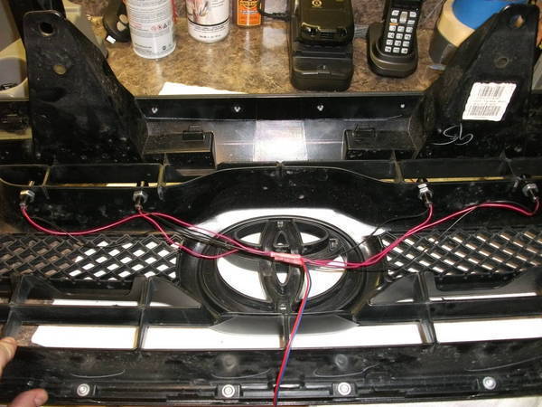

    Got my raptor lights installed, used the side bolt's from oznium. Did it a little differently than others by going from the underside of the fins so I didn't have to take off the outer skin of the grill.
    Also added some amber side emit strips to the lights while I was on the led kick
    Thanks for the inspriation!!
