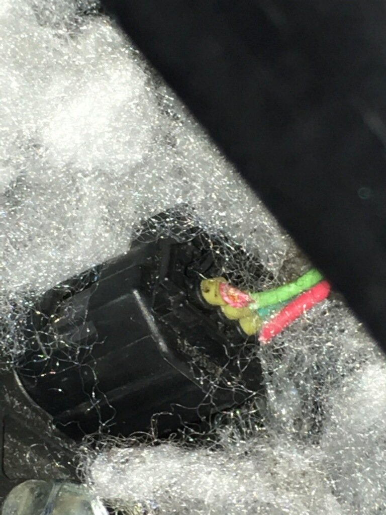

    cam sensor on the valve cover? i just replaced the engine harness on a 2019 taco on an insurance job from some kind of rodent. cam sensor was the first thing noticed. Dug deeper and found alot of messed up wires, i use peppermint oil around the car in the garage.. seems to work (had a mouse chew through the harness on my avalon before)

    [​IMG][​IMG] this one was the worst ive seen

    this truck was actually driven every day. until it wouldnt run anymore.

    oh god, this truck i cant tell how quick it happened. my avalon? destroyed the harness in 2 days. car sat for 2 days while i was away come back and wouldnt run
    ever since then i keep pepermint oil soaked rags around the cars. and the cats allowed in the garage now.

    squirrels ive seen damage more than mice. i still cant figure out what the hell was in this taco. it looked like a damn birds nest inside. chipmunks are bad too
