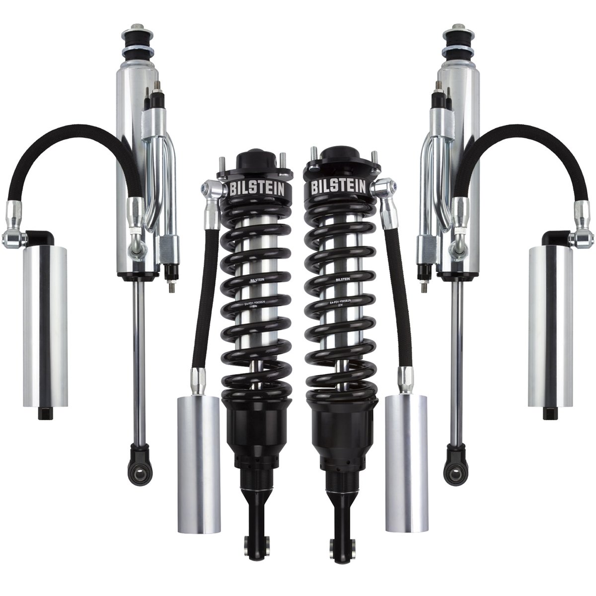

    • Bilstein 8112/8100 Coilovers and Shocks

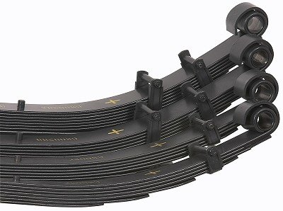

    • OME Dakar EL095R "light duty" leaf spring pack

    Why light duty for the leaf springs?
    How much permanent weight is that Decked system?

    I have the HD Dakar's with only about 250# of weight, and the ride is great. I'd go HD and take a leaf out if needed...

    The bilsteins he’s looking at have features that eliminate the need for bump stops and limiting straps.
    • ZoneControl® CR: Position sensitive damping with 3 compression zones and 2 rebound zones, controlled by 3 independent pistons
    • Compression (C): Provides superior bottom out control through a 2-stage, telescoping internal compression stop. This feature eliminates the need for an external hydraulic bump stop
    • Rebound (R): Secondary rebound stop will dissipate spring energy and stabilize the suspension directly following a large compression event. The internal rebound stop will also eliminate harsh top-out events and the need for an external limit strap

    8100 series don’t require the use of aftermarket rear bump stops Many people including myself are only using the stock ones although for whatever reason some people are running hydro bump stops when there is no need. Looks cool though lol
    If you got the money to burn for billets go ahead or just spend 400ish for JBAs/SPC UCAs.
    I have the 8100 paired with 6112s and the ride is a huge difference comepared to the bilstein 5160s. You could save your money in that route but if you got the money get the 8112s

    It weight 205 lbs, plus all my gear (tools, recovery gear, compressor, etc). Do you think I should get the Dakar HD rear springs? I just don't want it to ride rough.
    Roger that. Maybe upgrade to the HD springs.

    I just installed 8112s and 5160s with Camburg Moog UCAs and Wheeler's 3-leaf pack on my 2019 DCSB OR. I am very happy and the ride with 8112s is fantastic.
