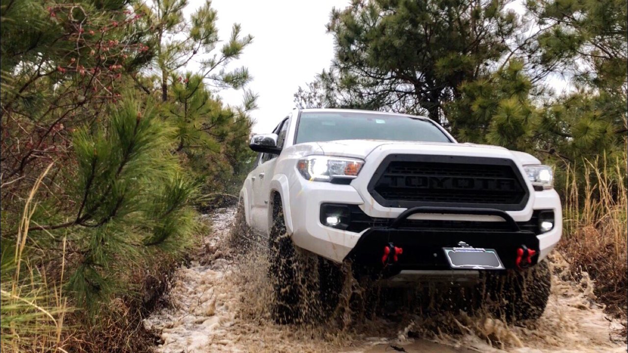

    Bilstein 8112/8100, JBA UCAs, Icon RXT leaf pack, work wheels 17x8.5;-10os, 285/75/17 cooper LTX AT3, Mobtown HC rear bumper and Sliders, SSO front bumper, BAMF greceased grill.
    Mainly due to budget. 8100 costs 1600ish bucks vs 350-400 bucks for 5160. Most people see it as “the rear is just along for the ride”
    IMO the 5160 can’t keep up with the 6112s let alone the 8112 when it gets really bumpy. It’ll get the job done don’t get me wrong, it’ll just be a bumpy ride in certain terrain. To me the better pairing was 6112/8100 due to both being the same 60mm piston. I know most would rather have the 8112 in the front, but trust me the 6112 is a damn nice ride and the dampening you get in the rear is COMFORTABLE!!
    Just my opinion though.
    Good luck finding the right setup!
