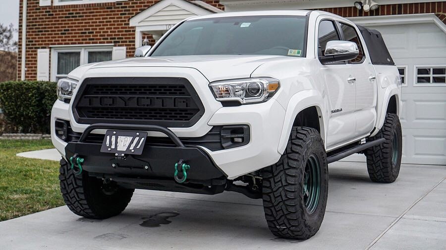

    The 8112/8100 is meant to be a great DD and a crazy desert runner. Look how bilstein advertised them on YouTube. 500 mile drive through the desert and dirt roads to SEMA and jumping it.
    I know most here talk about travel length as people wanna have the most articulation to rock crawl, but this setup isn’t really meant for that, there is no extended length option. I didn’t see the OP say he was gonna go to Moab and see what his truck is made out of, just hunting,fishing, camping, and heading out to the lake is all I saw. I see really no reason for a longer shock setup here.

    6112 install was done by a shop, 8100 was done by me. I could have done it myself but it was cheap to get it done with an alignment. I was at 5/4 which gave the 1.5” but the bumper made be sag a bit. So right now I’m at 6/5 setting which gave my a little over 2” with 650 eibach coils. One day I’ll get the 8112 but right now I’m satisfied.
