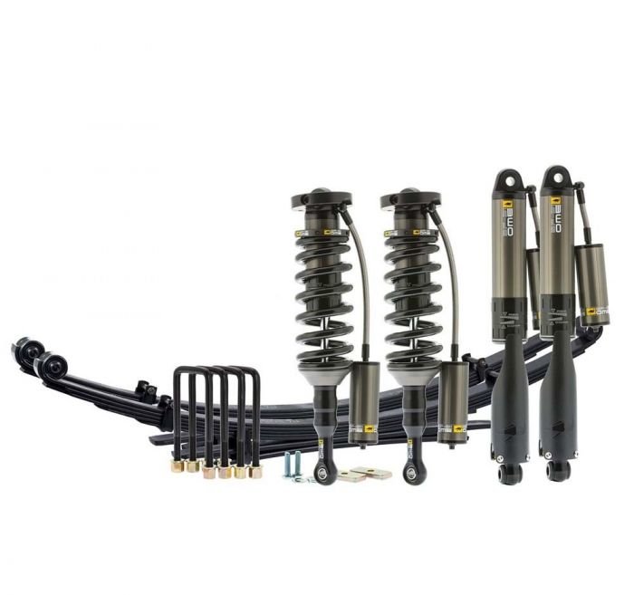

    I've done a little more research - I don't think my high-dollar lift plan is that great.
    I'm thinking about doing something a little more budget friendly.
    What do you guys thinks about the following:
    • OME BP-51 Lift Kit
    • SPC Upper Control Arms
    The OME BP-51 setup seems like a good bang for your buck. You're getting adjustable coilovers and a full leaf pack included with the kit. I am also familiar with OME as I had it on my 1st gen and I have it on my Land Cruiser. I think it would be a large step up from the OEM Toyota OR Bilsteins.
    I'm trying to fit 285/70/17 tires on my TRD Pro 4R SEMA wheels. Will this lift plan work?
    I've also considered just going with a conventional OME spring and strut combo to really save some cash.

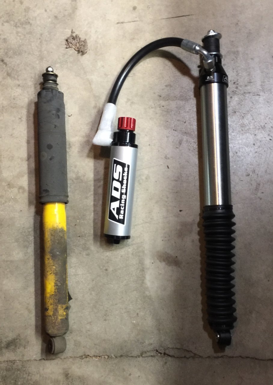

    C4Fab LoPro, BAMF Sliders, Ext ADS 2.5’s, 4.88's, OVTune (OG to KDMax)
    If you go with the extended travel 5100, yes.
    Consider this though and some may not agree, but let this logic sink in.
    That rear axle weighs ALOT and is moving up and down ALOT when going over bumps on washboard roads. Do you really want to put the cheapest shock in the rear?
    I did good front coilovers first and then added nice rears later when I could afford it.
    OME rear vs extended travel ADS rear
    At full droop the ADS shock shows 10” of shock rod , the OME shock rod was like 7-8”. So when going over obstacles the droop has more room to stay in contact with a surface. To start out the extended 5100’s may be ideal...wish I did that in the first place instead of the OME rears

    I also just glanced at the OME BP-51s on HeadStrong’s website. It’s a killer package deal - Includes full Dakar Medium rear leaf springs, full install kit w/ U-bolts and bushings, and free upper control arms, all for less than the Bilstein 8100 kit without any extras.
    Basically a turn-key coilover lift kit for $3,200. Crazy bang for your buck.
