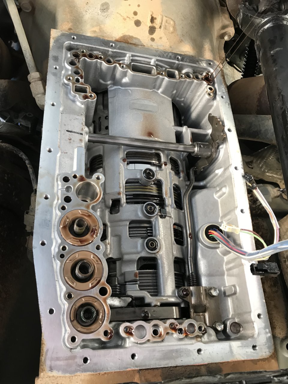

    Since i am a local interested in helping me remove my valve body? I think my tourqe converter is going to. Significant chatter that is Persistent.

    You just need a rehaul of the valve body is all. That shudder will go away due to increased line pressure and better clutch clamping power. If it does not, there is one other solution we will try but involves adding in some tranny fluid additive, but I refuse to try that until absolutely necessary.
    I am not sure that my recent huge spike in schedule activity will allow me to help out with something like that, especially if there is no rack present for the vehicle to be on.

    Well bad news. Just put the tranny back together cleaned up the bench and found a small part that must have fell out. Guess who gets to pull out the valve body again... this guy.
    I think when shuffling the valve body upside down etc a small square fell out. So back to the drawing board.

    Nope. I got all that stuff in there. This is a retainer for a valve in the actual valve body. It’s holds one of the various rods in place. Not sure which valve. I think 3-4 piston. Because is slipped pretty bad on my test drive.

    It’s now fixed. Just something to be careful of if you mod yourself. Quick dissembly and reassembled we are back in biz. It was the square retainer for reverse. No more slipping nice firm clean shifts
