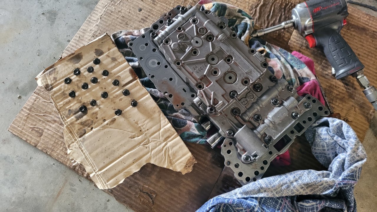

    Apologies for bumping a dead thread but I didn't think a separate thread was necessary.
    Installed the kit this past weekend. Took about 2.5 hours and was just waiting for a transmission filter/fluid change to do this mod.
    Holy cow I absolutely can't believe I didn't do this mod sooner. Shifts are nice and predictable and much more sporty like the truck should feel. At WOT it is a different animal. With 35's the stock tranny slips a bit but after this mod my whole front end lifts up as the transmission grabbing power is substantially increased.. fun stuff
    Only picture I got... Was too focused on tearing it apart lol

    Good job getting into that. It can be quite daunting for some.

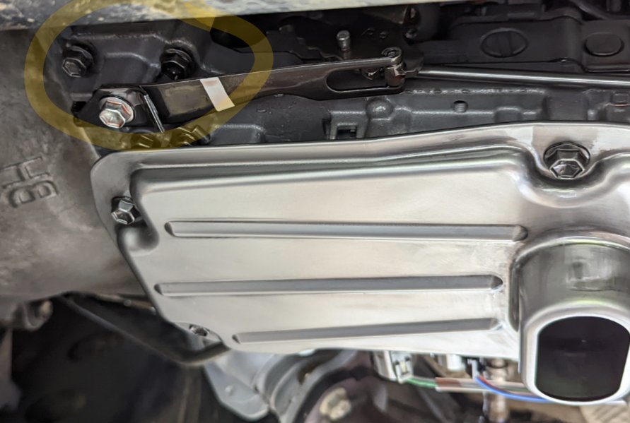

    Interesting. I didn't know that could be a cause for concern. I will check it out. Reminds me that I need to service my trans fluid this week. Weird but during a cold rainy day last week, I got an AT fluid temp light while I was driving in D. Downshift out of OD and maybe there was fluid in the solenoid, the light shut off and then hasn't come up again. Anyway. Will do a drain pan and replace the gasket this week and see what's up.

    Check your bolts. I tightened these. In fact all of my bolts were still to torque spec but these two in the corner had come loose. One was in the pan next to the magnet.

    Oh that’s scary. What made you open it up again?
