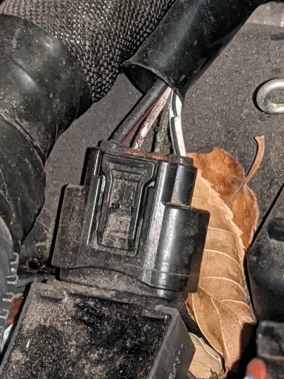

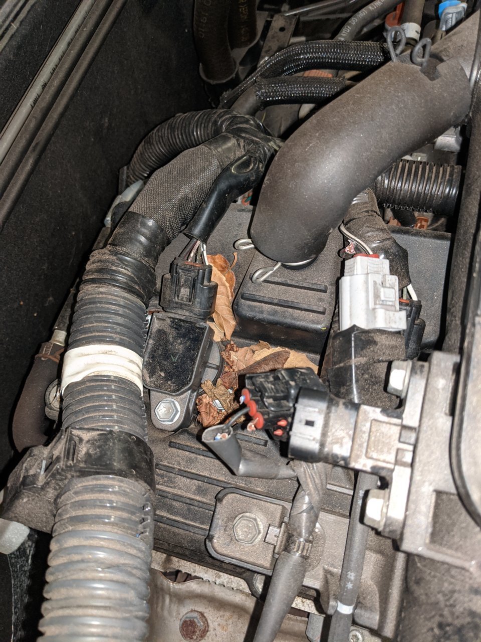

    Rats ate my taco! Can anyone please let me know what parts to purchase to replace the three wire harnesses that have been destroyed by rats in these pictures.
    I'm hoping someone can help me identify what parts to purchase to replace the wire harnesses.

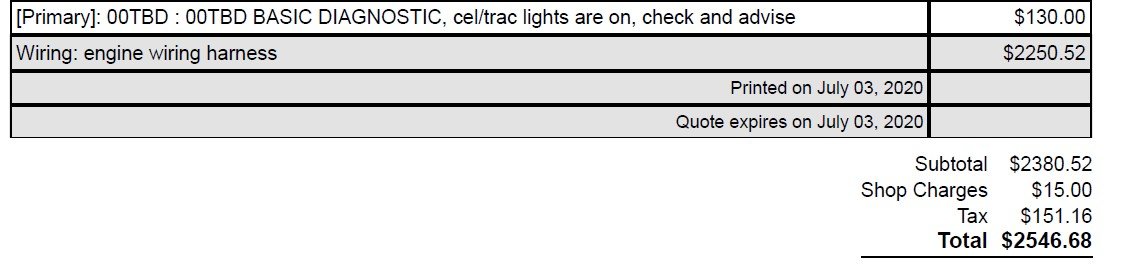

    Dealer quotes $2500+ so I'm pretty stressed. Any help you can offer is greatly appreciated!!!
    I am getting P2443 with Check Engine and Trac light on and the truck is in limp mode (20 mph limit). Having done some searching this is the Secondary Air Injection Pump voltage issue, which I assume is one of the wire harnesses in the picture.

    Unplug the connectors. Look very very closely on on the ends and you'll see some numbers. I use my phone to zoom in. Take those numbers to a dealer and they can usually hook you up with repair wires.
    There's a connector catalog somewhere here that lists them all with directions in dismantling the connectors to replace the wires.

    I’d try a salvage yard. Buy the whole engine harness.
    You can try https://www.car-part.com/ for a general idea and reference.

    That is definitely not $2500 worth of work. Those guys are trying to take you on a ride. A darn good one too.. take the advice above. You will end up in a severely better financial position after it's all said and done.
    FYI that wiring is easily fixable if you are handy with soldering. No need to replace entire engine harnesses. A good mechanics shop will take care of you for less than an 1/8 of what the price the dealer will charge you and it'll be good as new like it never even happened.

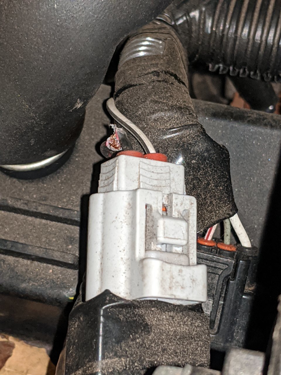

    Thank you sincerely for all the great advice and tips. I was able to identify the black connector as the secondary air injection pump connector so I was able to place the order for that part. However, I am stuck in finding out what the grey connector in the photo is. Anyone have idea what this grey connector is?

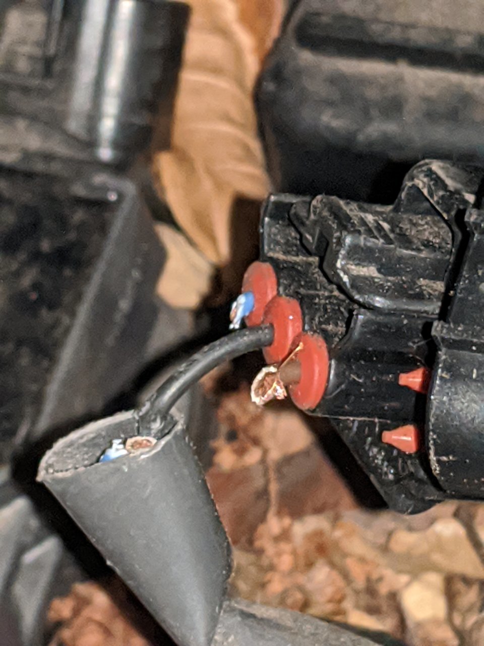

    To the folks who mentioned soldering -- Would it be reasonable to repair this damage just by putting some solder over the connection and then taping over it? I don't have experience with soldering but I'm willing to learn.

    some duct tape and zip ties
    Just came to here to agree with the others and say this would be a super simple fix. Even if you don't know how to solder you could spend an hour watching soldering videos on youtube, practice yourself, and have your harness fixed in a few hours - truck back up and running by the end of the night.
    Those pin connectors are usually pretty easy to get out in my past experience, too.
    ^I'm sure youtube or googling will bring up some tips and tricks for this as well

    I would take it apart and go through this site. you may be able to find cheaper on eBay though
    https://www.efihardware.com/products/c342/Toyota-Connectors

    Maybe the Knock Control Sensor Bank 1
    Connector K1
    ...Maybe
