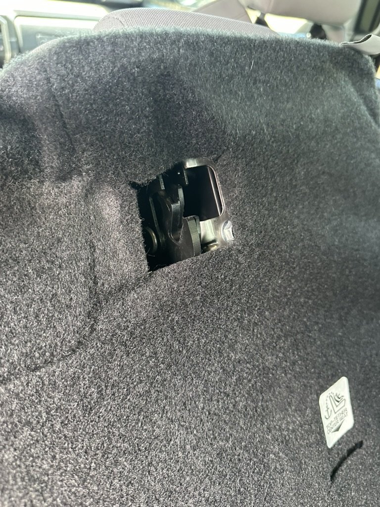

    I see. Thanks for the pictures. My sense is that this design is common in Toyotas but not sure. Perhaps this is a not-tight-enough tolerances issue.

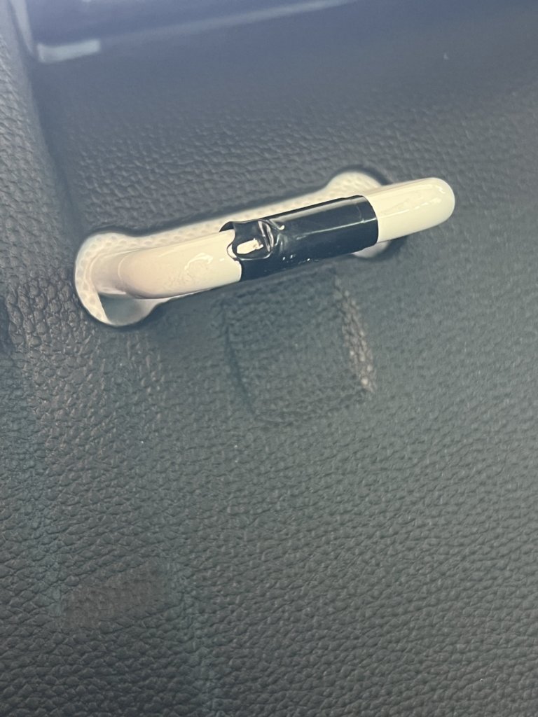

    beat me to it - that’s it - just wrap some electrical tape around that loop in the first pic

    Yeah - was never an issue for me on my 3rd gen. I think it’s more of a first run of vehicles issue. These issues crop up and they fix it over time. A 2022 third gen is going to have all these kinks worked out. All that said, I’ve now fixed 2 rattles (rear driver door and this issue) with some tape and my truck is now perfectly silent. Not bad for a new model.

    This electrical tape solution works but it is clearly not going to last. IMG_6689.jpg

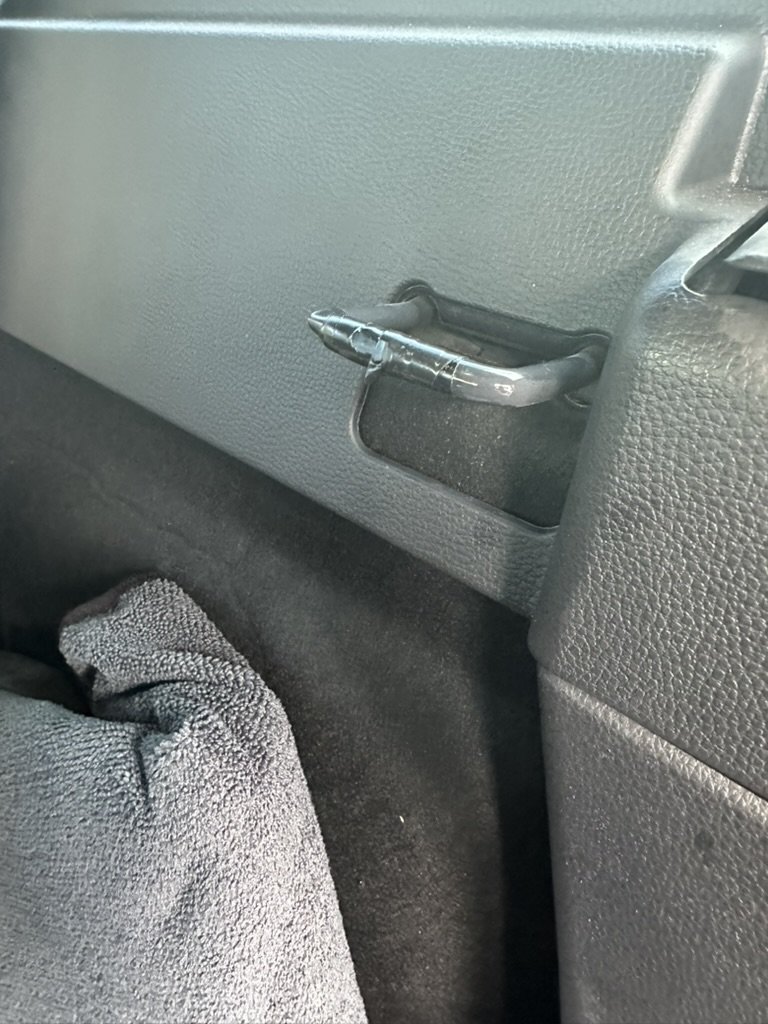

    Wrapping this plated piece works: I used white, wide-width cloth First Aid tape to wrap it. I hardly ever lower the seat backs, so it should last a long time. I also wrapped the ones on the metal floor under the back seat bottoms. I'm not sure how those work since the two halves don't seem to latch together: maybe a safety feature in the event of a rear-end collision.
