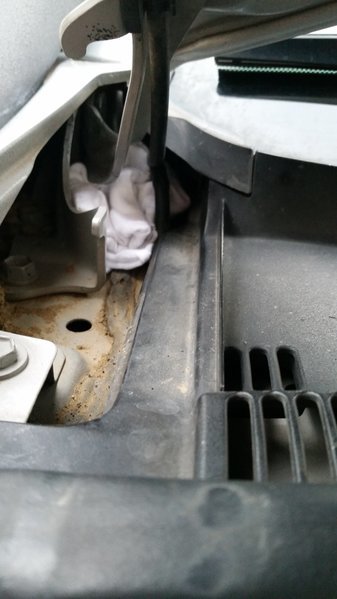

  16. May 30, 2017 at 8:00 PM
    #16
    1largemouth
    1largemouth Well-Known Member
    Mar 21, 2016
    #181964
    173
    Martinez CA
    06 Tacoma
    Same rattling noise here for years, thought it was inside under the dash for sure! Yea there are some things that r a lil loose but wasn't the problem. I was banging on my hood nearest the cowl area and there was a rattle on the pass. side. I think the hinge is worn out, anyways as fortech above said " stuff a rag in there" BAM!!! F'N rattle gone!!! 20170530_193314.jpg
