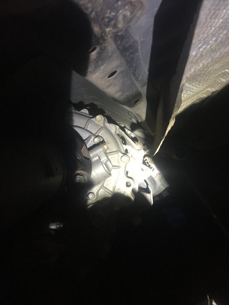

    Horrible pic i know. But you can see mine just to the right of the drive shaft thegold bolt

    @xweslingx did his, I'll let him explain though haha I know it will work though like what Chris is saying

    He could do an fj case..? They have tcase sensors

    Yes he can and should but again its that much more work and moneys.

    All the electronic tcases have that slot. I have a 2010 with it and running the sensor from RST for months now

    Yup my 14 has it

    Sense yours is a 09+ is yours plug and play or what did you do to set it up? Have you deleted the abs modual compleatly or are you holding onto it because of its connection to everything?

    Pretty much plug the sensor into the tcase and splice into the abs module harness. I kept the module but my rear abs sensor cables are all gone

    So do you have the lights on the dash still or did you flash/rewrite the ecu

    I did but I pulled my cluster and removed the abs, brake and traction control LEDs. No lights now and tranny shifts like stock
