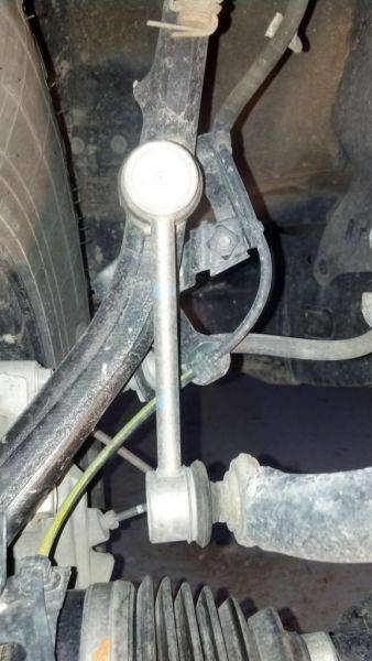

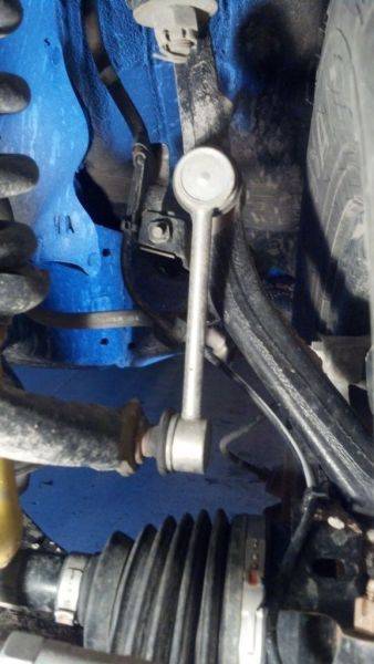

    I found it!!!! I had my father in-law stand on the running board and bounce the truck up and down and used my cheap Harbor Freight "stethoscope" to isolate the noise to the sway bar end link. I JUST put new ones in because the old ones were already rusting and had gotten cross threaded when I removed them for the lift. The noise is coming from the bolt that bolts the end link to the sway bar. I can actually see it popping up and down as the truck bounces.
    Now, I was fairly careful to install the new end links in the same orientation as the OEM ones, but who knows, I may have goofed that up. Does anyone know the correct orientation of the sway bar end links or have a pic?

    Here is what I just took of my truck. Glad you found it.
    Driver side
    Passenger.

    Thanks SkidooMan! Much appreciated! I will see if can look at my old parts for comparison.
