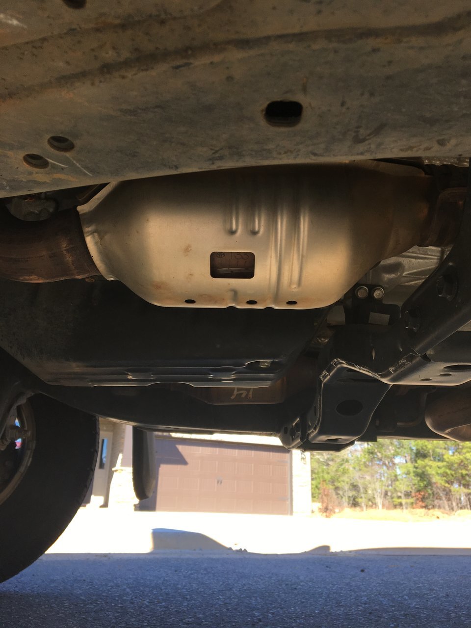

    I’ve beem experiencing this too. I have tried a number of things. I have recently gotten under the truck and listened closely. I believe now that the noise is the exhaust pipe. It sounds like it’s coming from the part that gets fatter in one spot and has a shield around it.

    My 09 had same symptoms for years. Only in the cold and sounded like it was down by the pedals. Turned out to be the gasket on intake snorkel in fender.

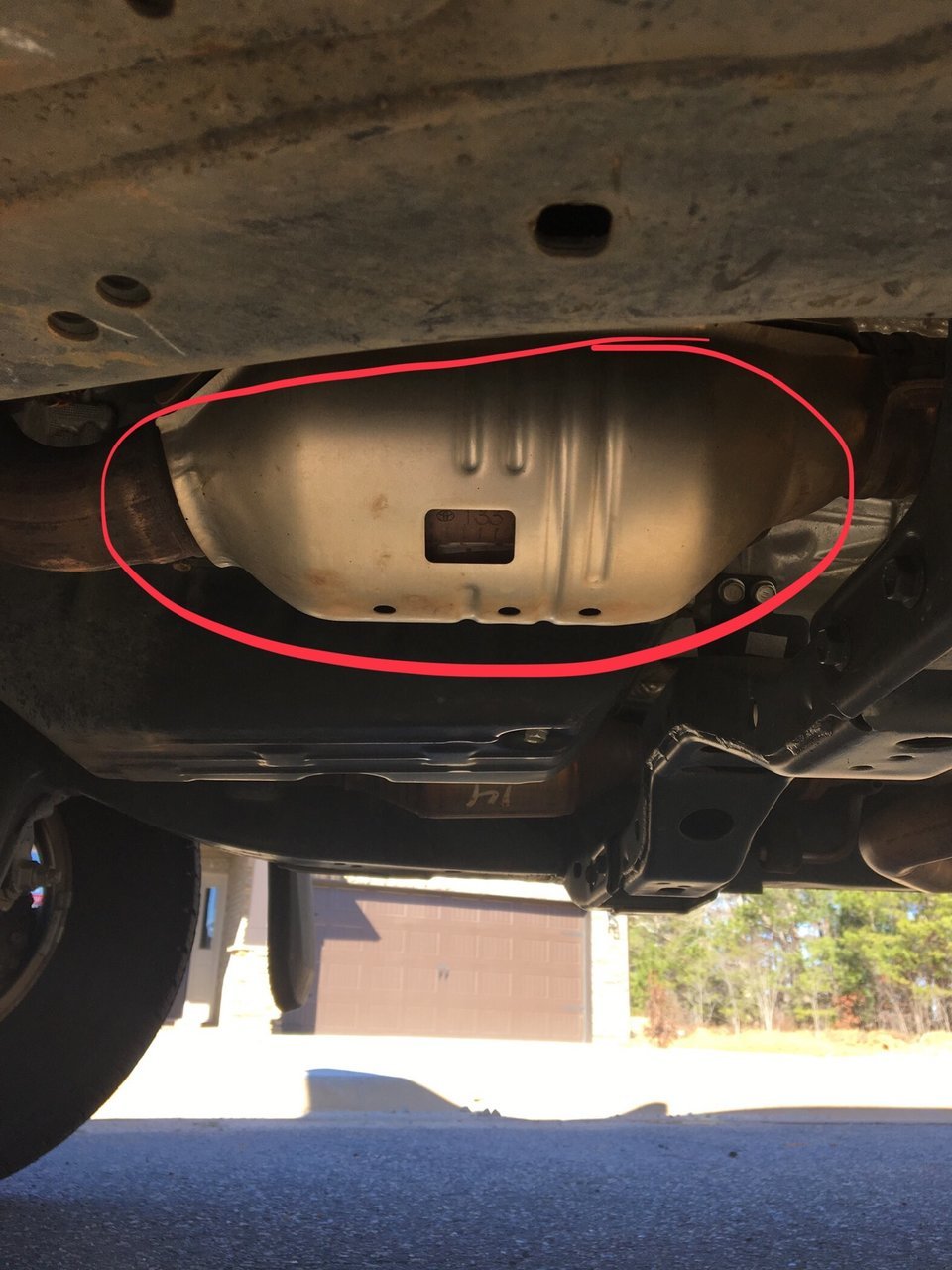

    The noise is coming from here. It’s echoing around so it’s hsrd to tell but I think I’ve narrowed it down to this.

    Same noise here. I put a screwdriver to that area, as well as around the bell housing and (in my case) clutch slave cylinder, oil pan, etc. It sounds like something is knocking somewhere for sure. I assumed it was something to do with my 6 speed, but looks like you have an automatic, so it's not the transmission.
    Noise goes away after warm up, at least as far as I can tell. I've never been able to pinpoint the origin, though.

    A common thing I see is the exhaust clamps rust rotting. Check your clamps!

    This is what I’m saying is making the noisy. After warm up it’s less noticeable.

    My cat heat shields kept getting rocks in it. Removed it and havent had a rattle from it since!
