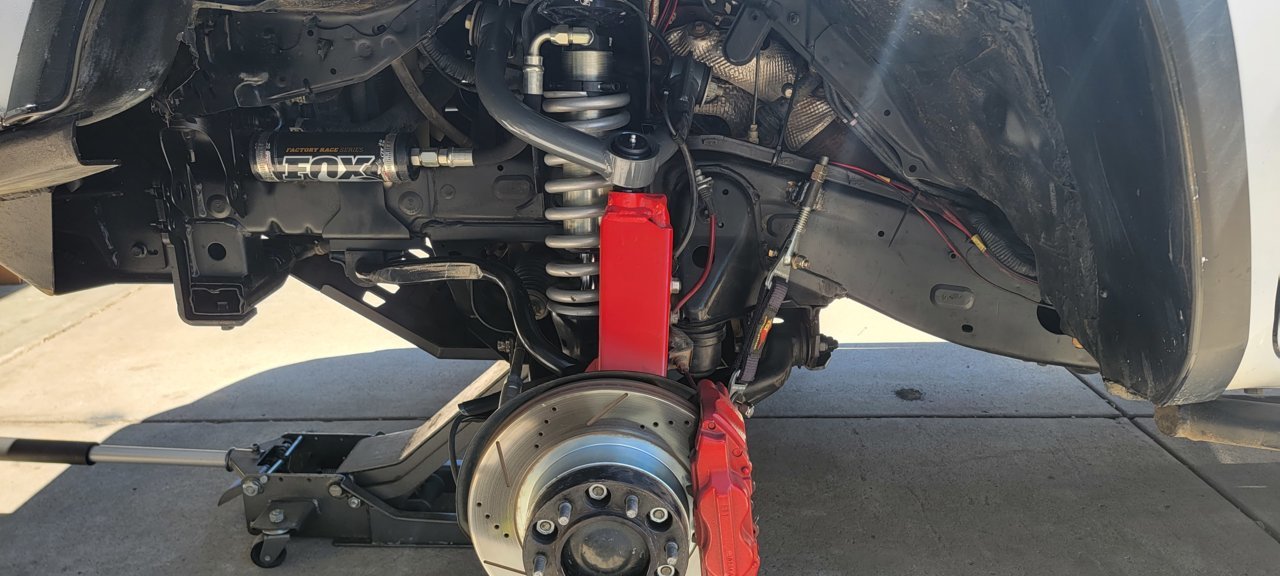

    Not sure, you can use MOOG K6292 ball joints or any other brand equivalent. JBA copied the bolt pattern so they should fit. I would only be worried about the actual ball joint size since JBA ball joints fit snugly into the UCA, see pic below:
    If you look at JBA's website, it states what part numbers the JBA ball joint replaces: https://jbaoffroad.com/jba-upper-ball-joint-k6292.html
    But as @JayRolla points out, JBA revised the specs when they began having bespoke ball joints manufactured for their UCAs. The ball joints that JBA has manufactured for their UCAs have 90 degrees range of motion, 40 degrees on up travel and 50 degrees on down travel. I don't know how that compares to Moog ball joints and their equivalents. The only recent revision I am aware of is to the poly-boot due to the cracking of the previous design.
    Edit: I forgot to mention, the JBA ball joint is rebuildable as well for only $60ish. https://jbaoffroad.com/jba-upper-ball-joint-rebuild-kit-for-jba-k6292-b.html

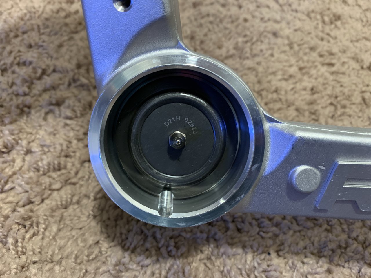

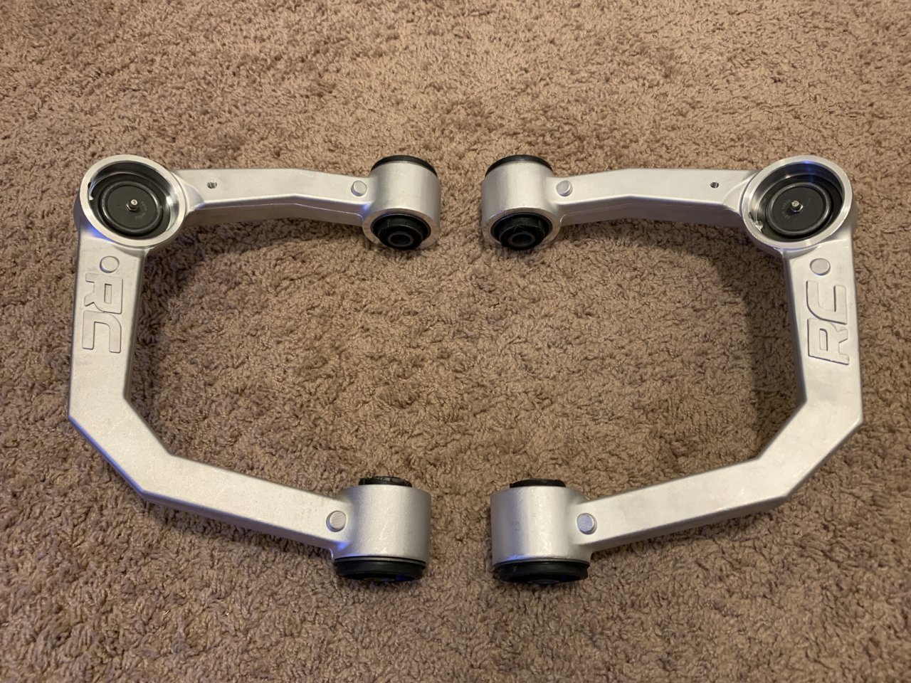

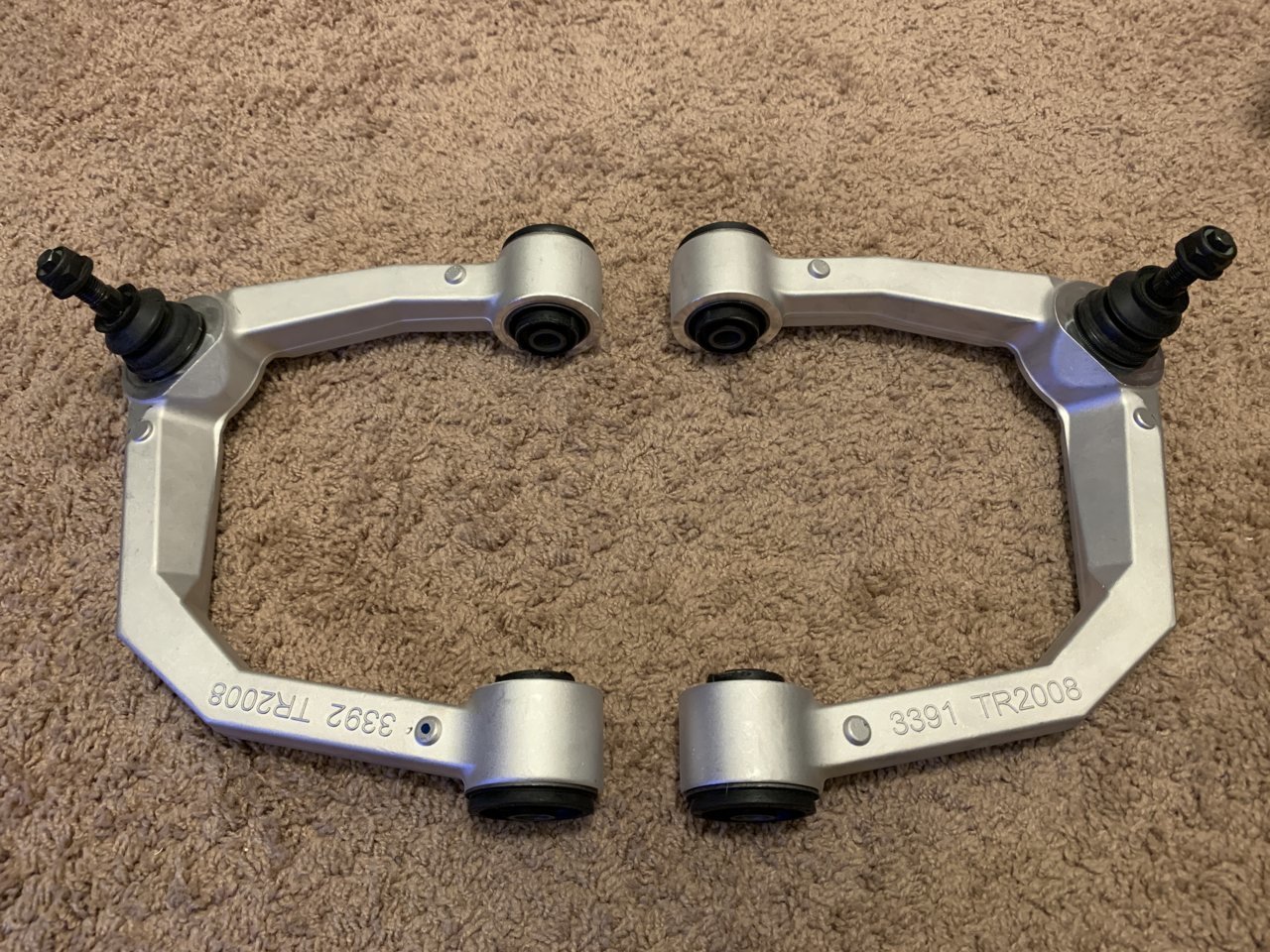

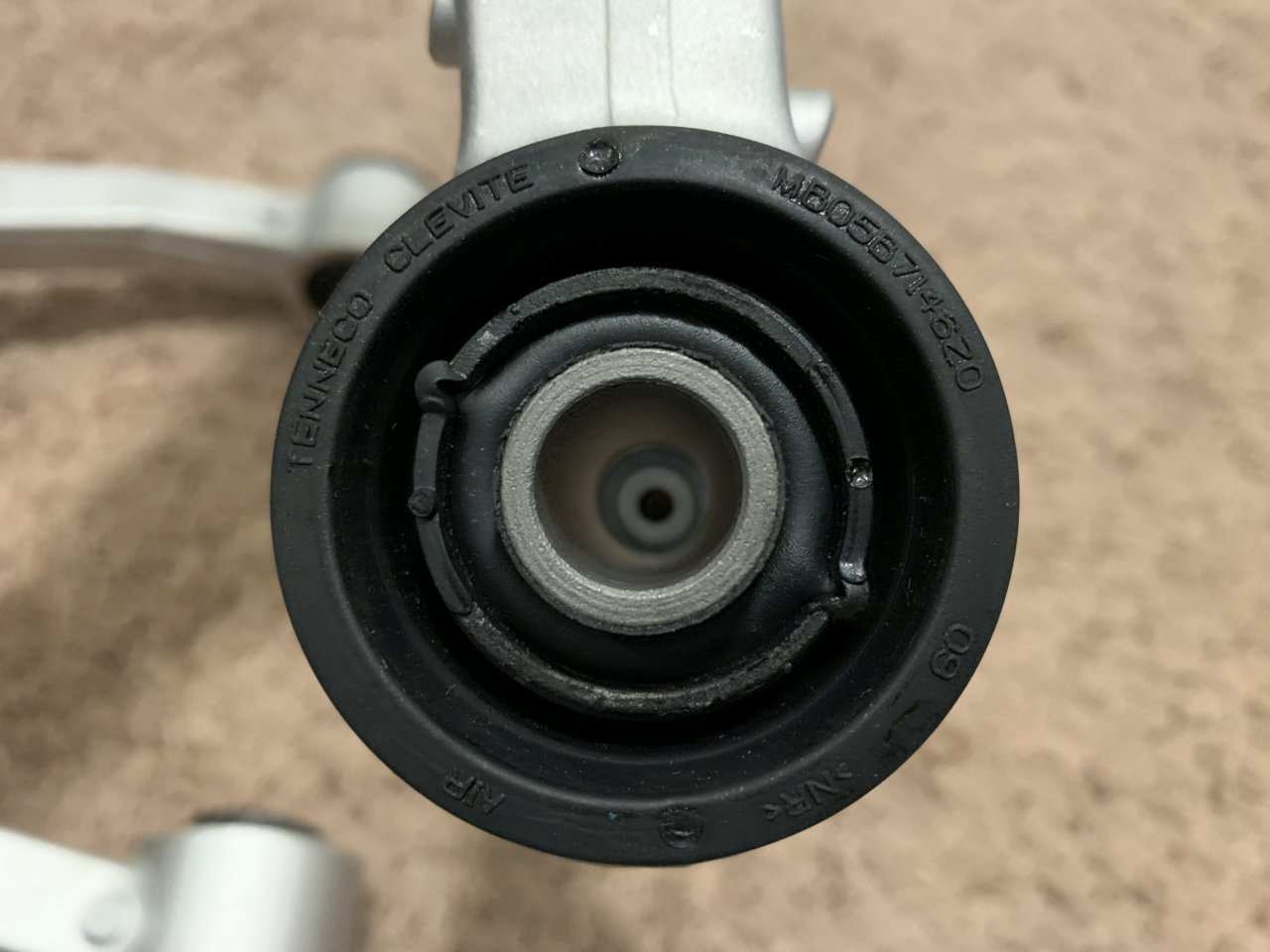

    I already got them delivered from Rough Country via FedEx.
    What I can tell so far they look like quality parts.
    Going to install them tomorrow!
    Toyota Forged Upper Control Arms (05-21 Tacoma) UCA
    Brand: Rough Country
    SKU: 74201A
    $269.95
    Here are some high-res pictures of them...

    Dude, you rock!! Those ball joints are equivalent to MOOG K6696, which is for 2001-2010 Chevy 2500 diesel trucks. Or even MEVOTECH TXK6696 which supposedly have more angle and are more durable.

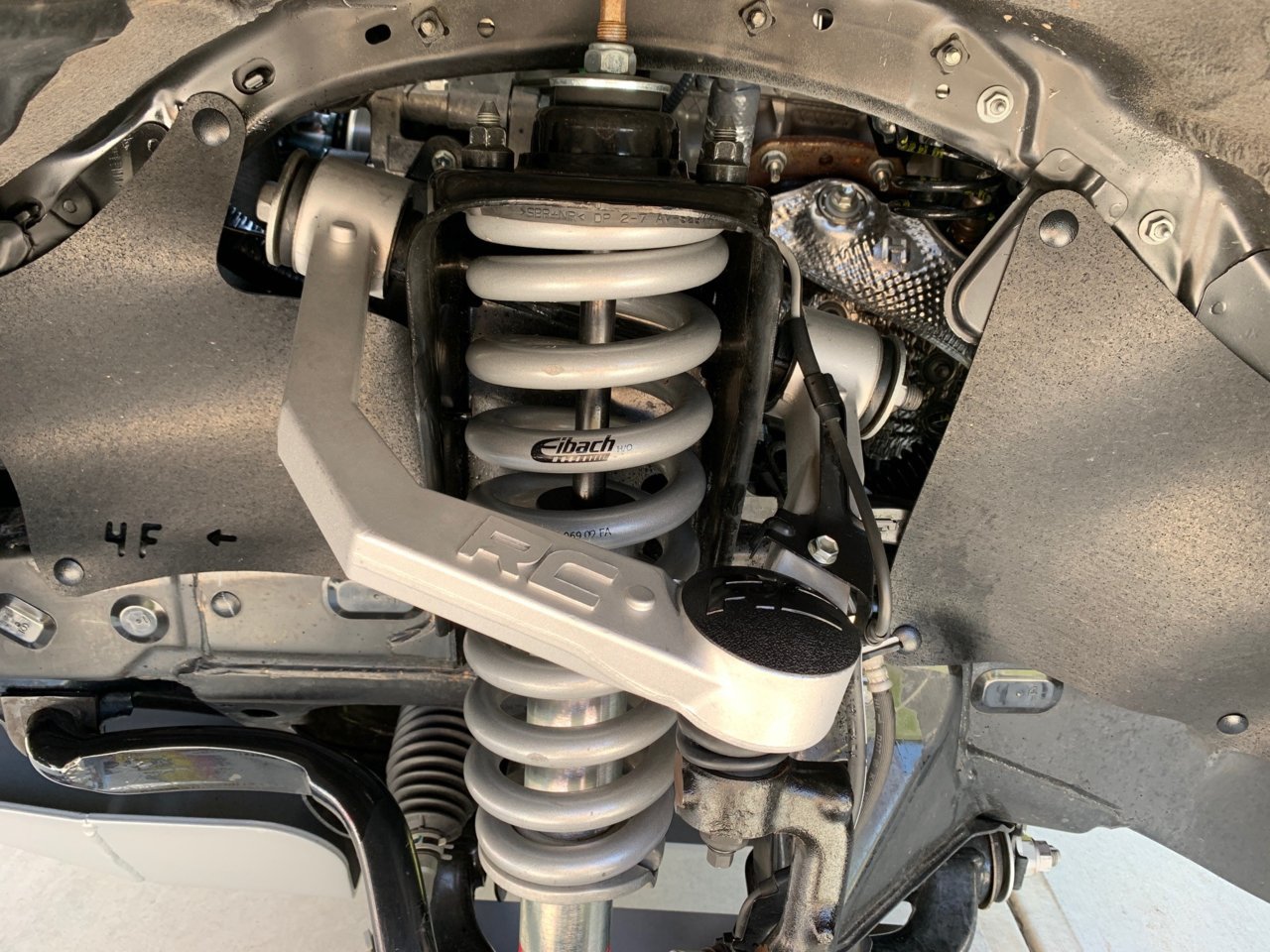

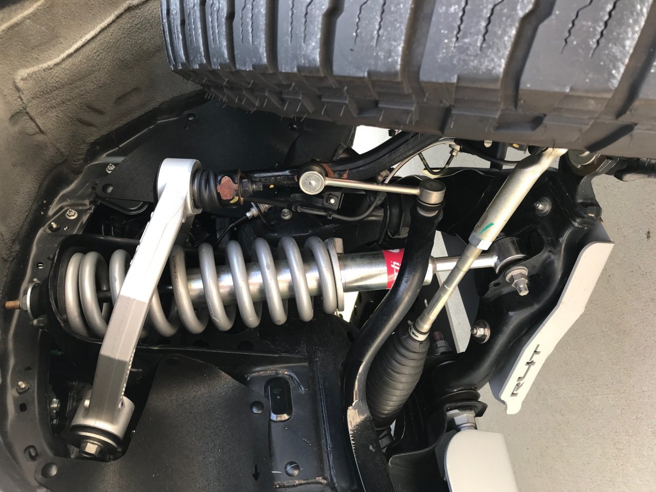

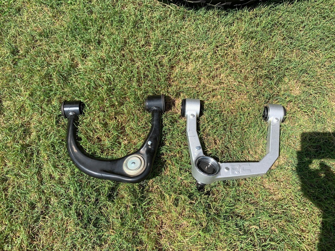

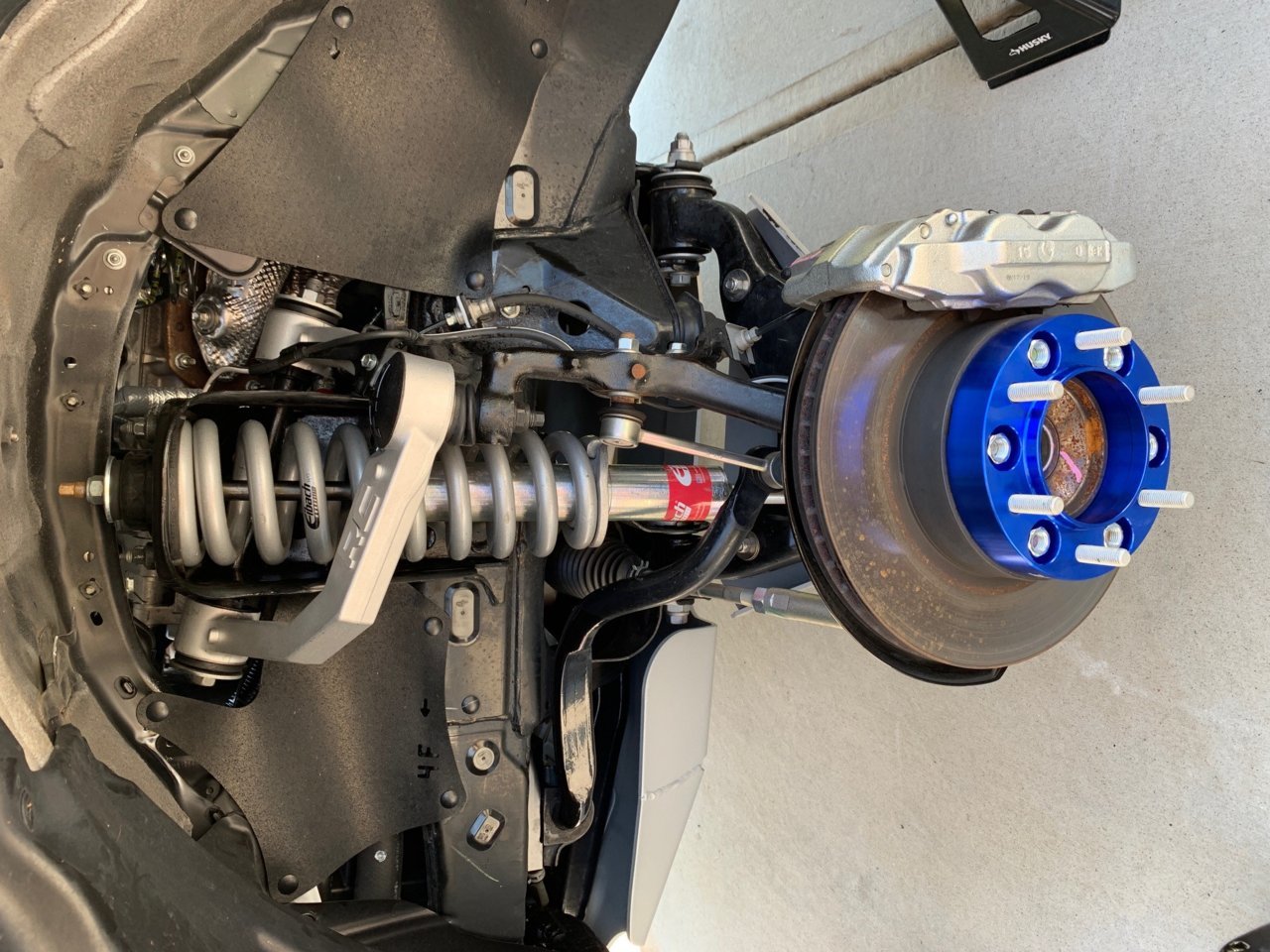

    Here are they installed on my taco with 3" lift.
    Install was a breeze :)
    Love the look and how they perform so far.
    Probably the best budget friendly UCA out there!

    All control arms are the same pretty much. They have additional 2* caster.
