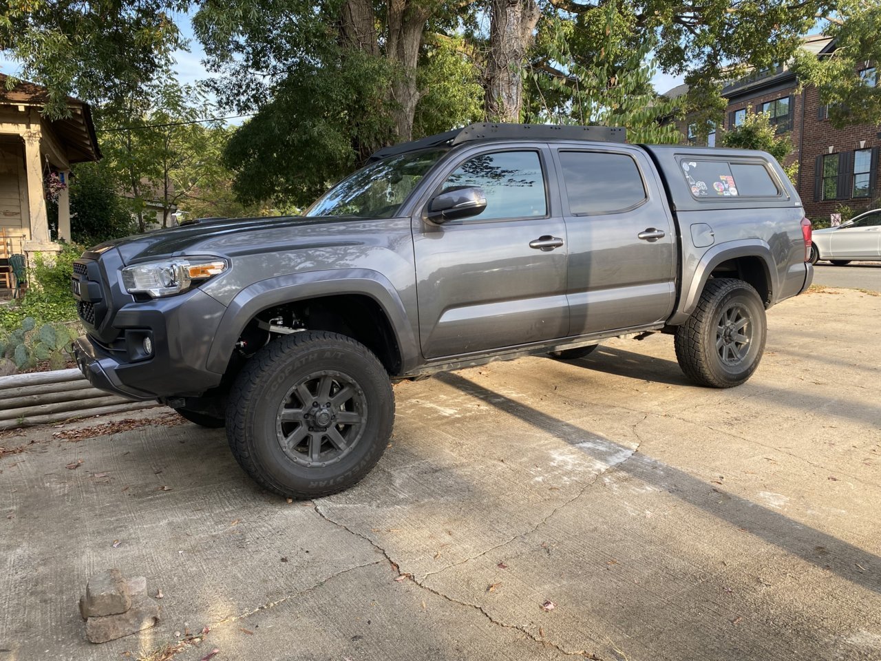

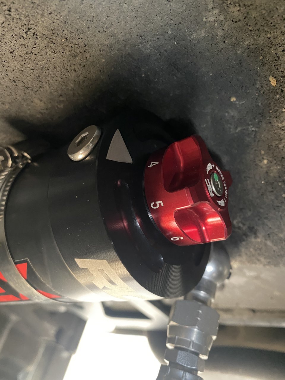

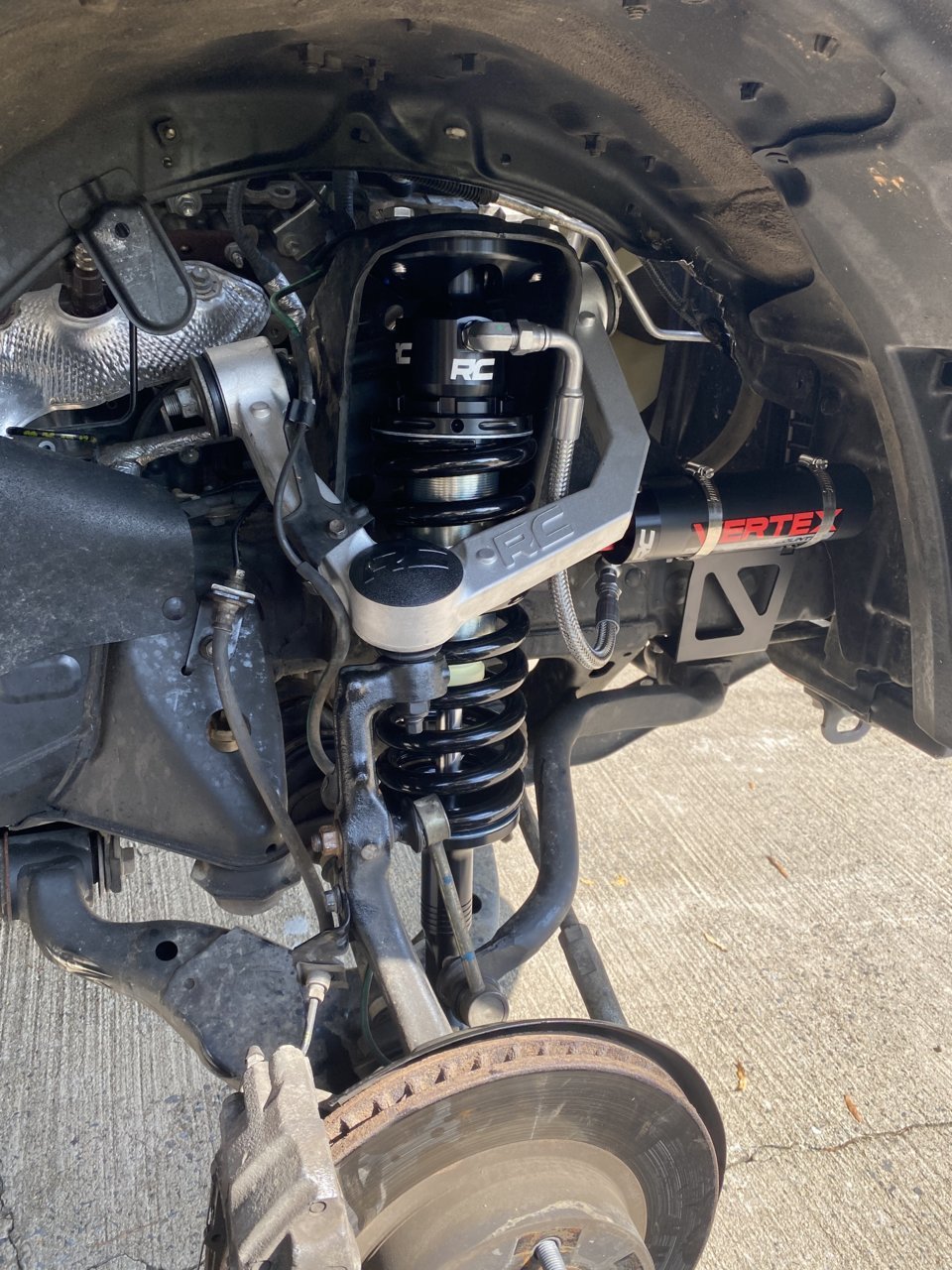

    UPDATE
    Installed both RC ucas (3.5”) and RC vertex coilovers (3”).
    This lift feels so so much better! and the handling is much stiffer. Before I would go over a slight hump and it would fell like it’s about to bottom out lol now it’s like that hump is barely there. I highly recommend these for a budget build like mine!!
    I had the spacer ready lift on there before 3”/2”. From the ground to the fender I was sitting at, passenger side 39” and driver side 38.5”.
    Now after install I’m at 40” passenger and 39.5 driver side. Hoping it comes down a bit bc I have a higher rake in the front then back. Back still has block spacer, will add leaf in the future but it’s working for me now.
    I’m running 285/70/17s not sure about the off set on the wheels but there’s no rubbing when in drive but a tad bit in reverse, I suspect that it’s the braided coilover line kissing the inner tires.
    Got the “clickers” set on 4 right now and out of the box I did no adjusting!
  12. Oct 2, 2021 at 3:05 PM
    #72
    beveryrad
    beveryrad Member
    Jun 10, 2020
    #330974
    10
    2019 Toyota Tacoma 4wd sport
    Double cab short bed. 3inch ready lift, diff drop, 285/70/17 stock trd sport wheels w/ black out decals
    Needed to still button up a few things but you get the idea!7F46BF86-6120-4698-A31E-527B4B8A9740.jpg CDE4B408-5C36-4680-95BD-ED0652A64288.jpg

    Looks good. How you liking the UCAs?

    I’m loving them, complete game changer for me. We will see how they hold up. But real solid materials I will say.

    Yes they are completely adjustable, I need the spanner wrench (should be sold with them, but it’s not) but I wanna see how much they come down in a month or two before adjusting.
