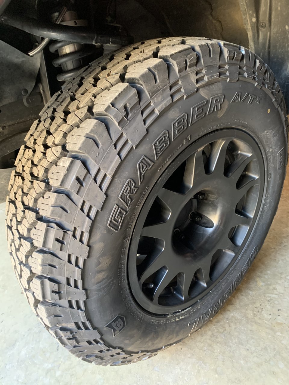

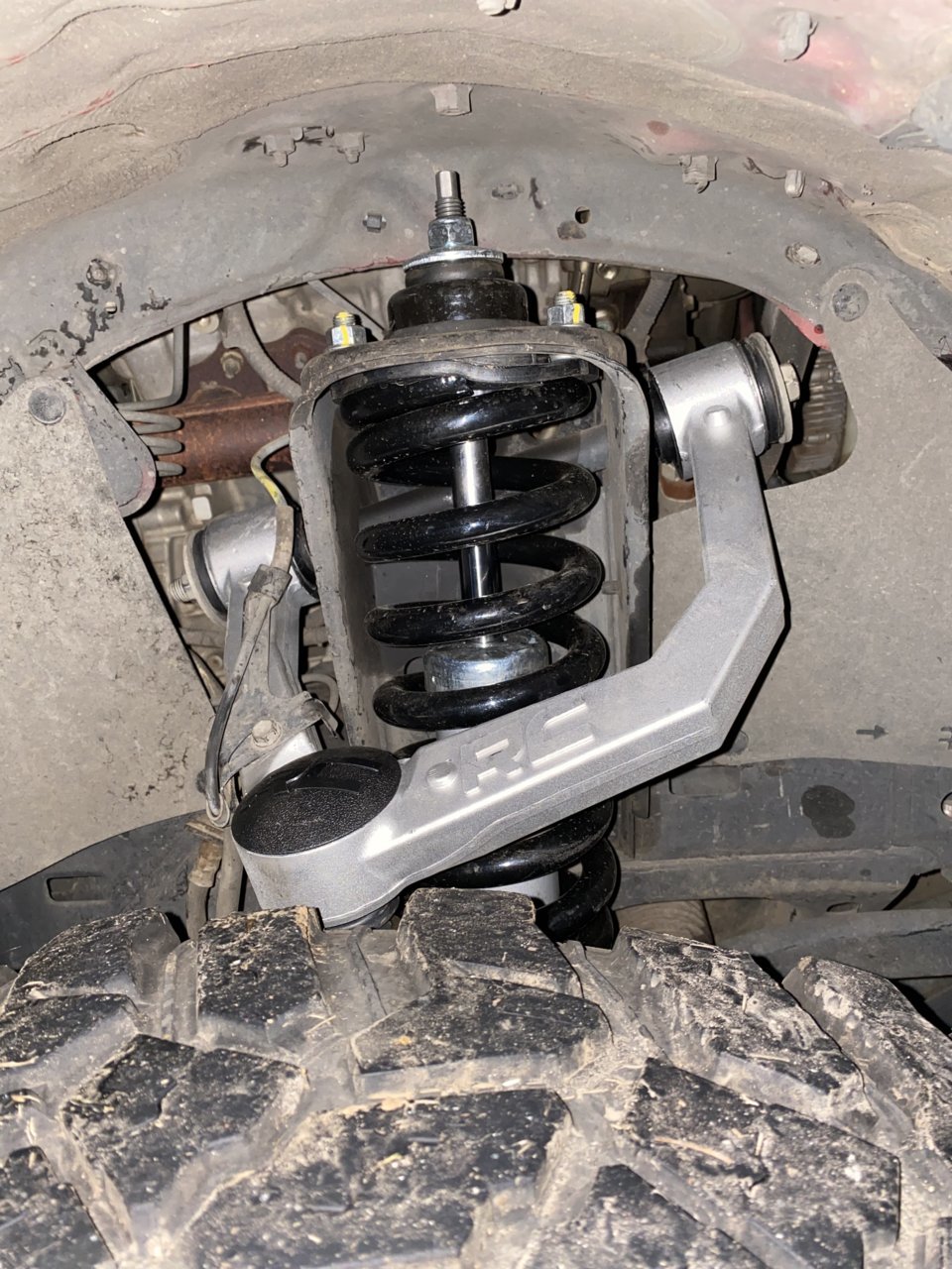

    Are the better than my old TC’s, yes/no. They are fairly beefy for $280 and the ball joint is greasable. Time will tell, these pictures are fairly old. If you’re not going to go out looking to break them and you’re into light wheeling. They’ll probably suit anyone in that category just fine. They might even live through a decent beating, but I’m not trying to purposely go out of my way to break them. I will however put them through a-lot of abuse from the dunes, mud, trails, to bump goat trail fire roads.

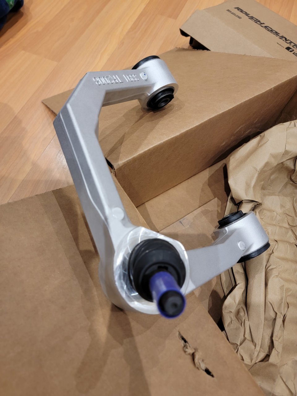

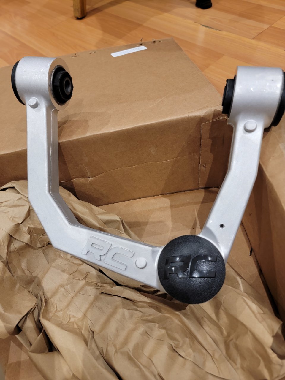

    RC states that it is proprietary. Can't give you a straight answer, unfortunately. I will say that you need to make sure you are able to adjust your Lower Control arms before installing these. If you can't (typical LCA seizure issues), I highly suggest ordering LCA as well.
