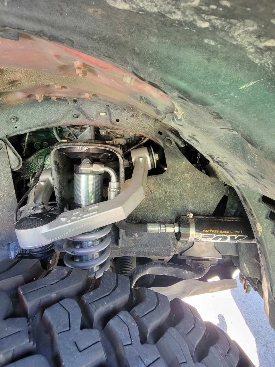

    That looks great!! The fact that you only have slight rubbing with 285's is really good. I think RC is trying to turn a new page with regards towards their past reputation. I've been reading some good things about some of their new shocks, looks like they are really trying hard to improve their name and produce higher quality parts.

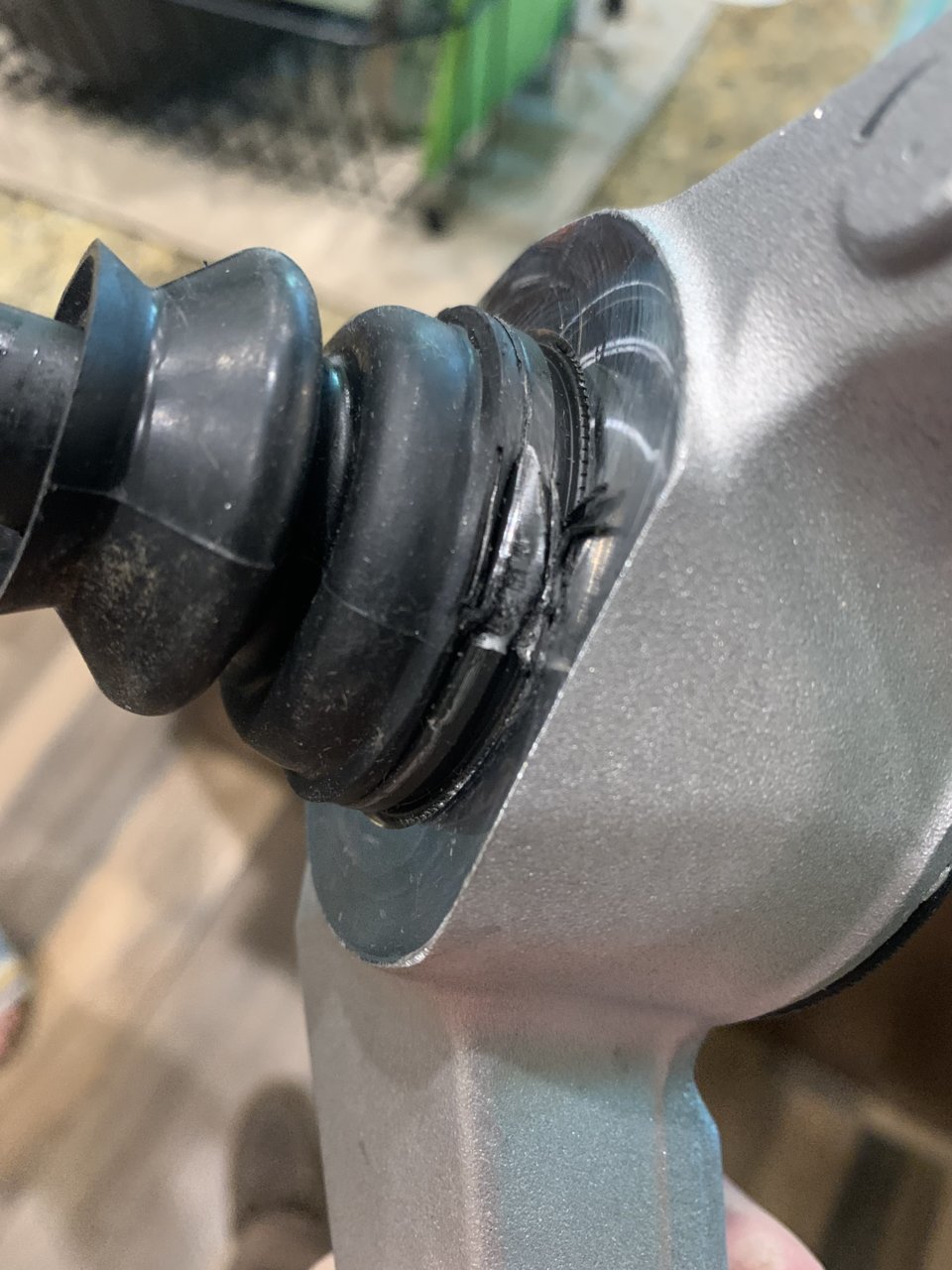

    Mine showed up today and one of the ball joints looked like this underneath…I’m gonna send it back for another, just fyi

    That's no bueno. Glad you inspected before install.

    Ya grease would’ve been everywhere. I contacted them by phone sent a few pictures and they shipped a new one that day no questions asked. I even get to keep the messed up one for spare parts

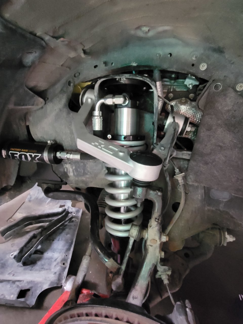

    Just got them installed with my fox 2.5 resi ext and I know the preload is crazy but I wanted my 3" lift.

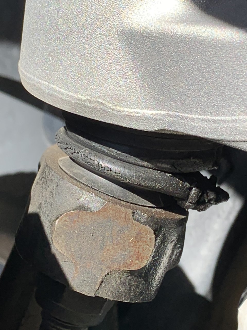

    Well it’s only been a few months with the arms installed and the first red flag has made its self visible. The ball joint rubber boot has already dried up like an old tire and is now leaking, cheap ass rubber. I contacted RC and they sent me a new set of ball joints no questions asked in warranty, but that is still a major flaw. Other than that they seem alright for the $.
