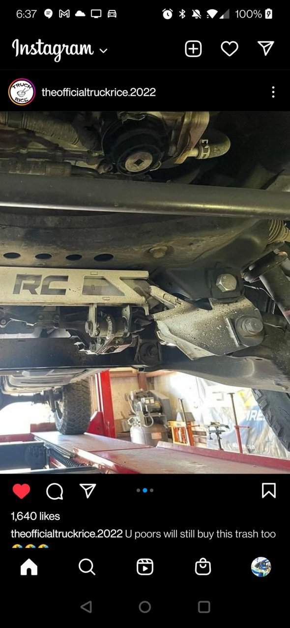

    CowboyTaco
    CowboyTaco $20 is $20
    Aug 19, 2010
    #41928
    6,797
    North Georgia
    11 TRD Sport
    :puke:
    Phil4200[QUOTED] likes this.

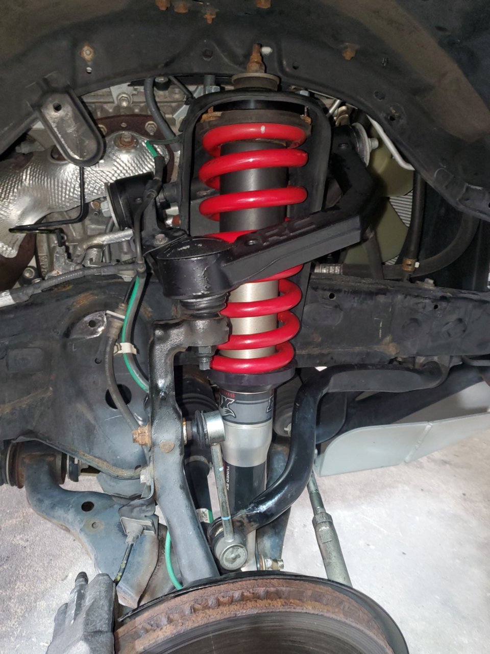

  10. Nov 6, 2022 at 6:38 PM
    #130
    dayusmc
    dayusmc Well-Known Member
    Nov 26, 2010
    #46734
    140
    NJ
    2018 TRD
    20221106_123136.jpg I put mine in today. Painting in the wheel well and frame while I am at it. I painted my UCA black, I like the more stealth look...

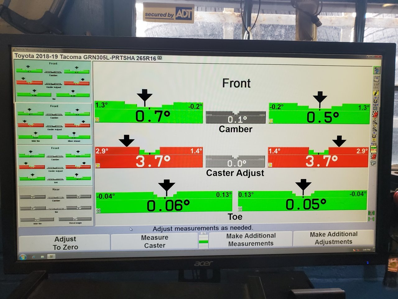

  14. Nov 9, 2022 at 11:26 AM
    #134
    dayusmc
    Nov 26, 2010
    #46734
    140
    NJ
    2018 TRD
    So here is the Alignment, not sure I am happy with the way it rides...
  15. Nov 9, 2022 at 11:42 AM
    #135
    somebody
    somebody GAR-FAB.ca
    Feb 11, 2019
    #282699
    1,155
    Jason
    Durham ON
    19 DCLB Sport
    Is it kind of wandery across the wheel troughs in the pavement/ wants to ride up and down them?

  17. Nov 9, 2022 at 11:56 AM
    #137
    Lucario Runner
    Lucario Runner Resident Truck/SUV racer
    Jun 29, 2011
    #59067
    7,198
    Robert
    San Antonio, TX or nearest race track
    06 Toyota 4Runner
    AFE stage II intake, APR X1, URD 70mm Throttle Valve (ported and knife edged), NST intake manifold spacer, URD spec U headers, Denso IKH20, URD fuel pump, APR fuel rail, URD Y pipe, URD spec u catback, lightweight water pump pulley, Greddy sandwich cooler plate, Earls oil cooler, IPT valve body, FJ TRD shocks, Cusco front and rear sway bars, Energy Suspension rear track rod bushings and rear link bushings, Carbotech pads, Stoptech ss brake lines, Stoptech slotted rotors, Motul 600 rbf, Limited Grill, Painted hatch cover by me, Painted valve covers by me, Cobra CB, TRD rad and oil cap, Escort 8500, Autometer oil psi and temp gauges, AEM wideband afr gauge, Flexpod, Pioneer 400w speakers.

  18. Nov 9, 2022 at 12:13 PM
    #138
    somebody
    somebody GAR-FAB.ca
    Feb 11, 2019
    #282699
    1,155
    Jason
    Durham ON
    19 DCLB Sport
    thats all in the high caster. I'm in a similar boat with the Rancho UCA's from rock auto. Sold for a 3" lift and caster is in a similar ballpark. No worries with tire wear tho, already have at least 5000k on mine.
  19. Nov 9, 2022 at 12:17 PM
    #139
    dayusmc
    Nov 26, 2010
    #46734
    140
    NJ
    2018 TRD
    When it had more caster it actually was better. Starting was around 5 when I put the UCA on. I think it actually needs to go back up and also I think the Toe is making it feel a little jumpy
  20. Nov 9, 2022 at 12:18 PM
    #140
    jakemellow
    jakemellow Member
    Mar 21, 2017
    #213944
    10
    jake
    Morin heights, Quebec
    2016 TRD sport crewcab longbed
    Level lift, 30", black softopper
    Is this dialed in for 3.7deg of caster, or is the adjustment maxed out?
