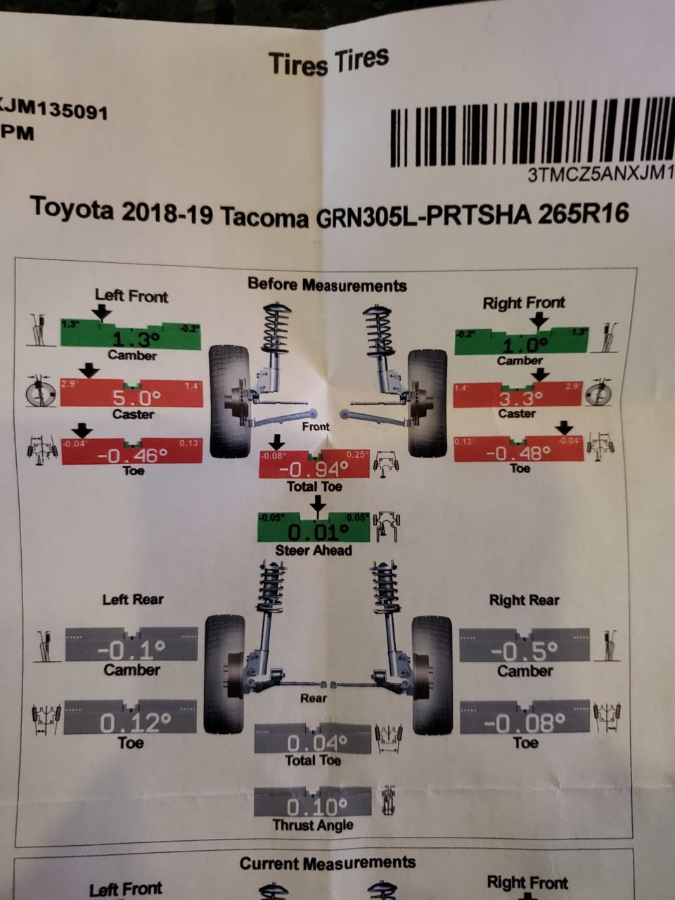

    Did you opt for no cross caster? To account for road crown. A little more caster on passenger than driver.

    This will pull right,

    It doesn't pull right. It is hard to explain but when you go to change lanes a little turn of the steering wheel makes it turn quick

    Do an AAL instead of block in the future if you want. For the caster on the alignment typically shops will add a 1/2 degree more caster to passenger side to account for road crown. That is what I was trying to explain previously. The alignment sheet you provided seemed to be the opposite thus causing the truck to pull to the right.

    The truck does not pull to the right...,.

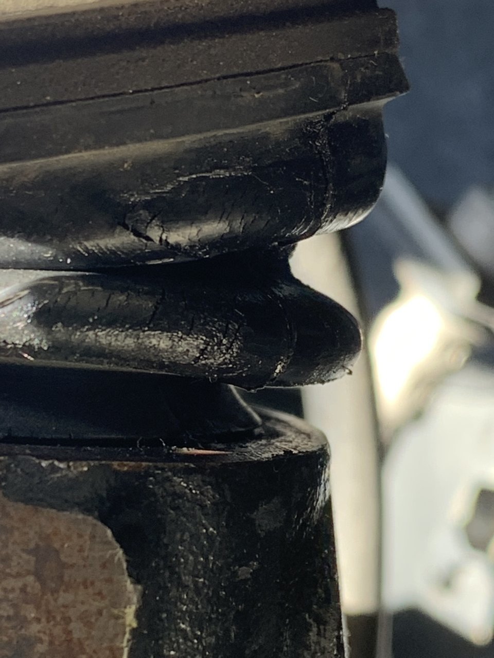

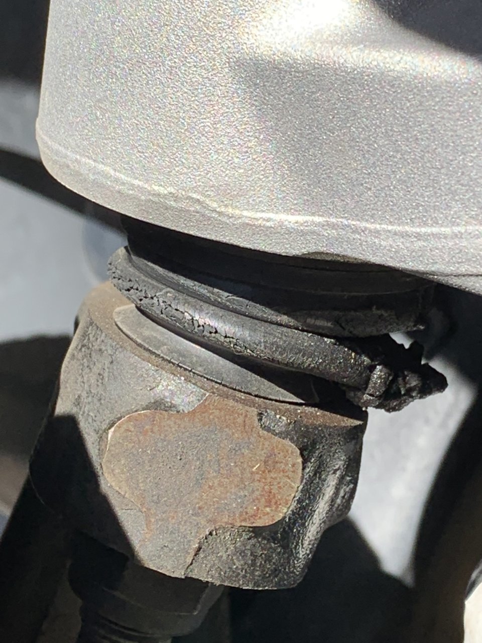

    Phil, I find this interesting. What was your maintenance like on these ball joints? Could you have maybe over or under-filled them with grease? They shouldn't be like that after just a few months. That's ridiculous. Maybe you're just snakebit when it comes to upper ball joints lol. How are the new ones they sent holding up?

    I haven’t had new ones installed yet. I did not over grease, the issue is Rough Country uses poor rubber I guess. The boots were just dried up and cracking like an old tire. Even my rubber rear shock bushings are starting to do the same.

    Are they like that everywhere, or localized to that spot?
    Its hard to tell in the picture, but it looks like a localized spot to me. It also looks like they came in contact with some pretty intense heat. Is there any chance that a tire rubbed on them?

    No heat other than it gets 110 deg here in californias Central Valley. No tire contact just crappy rubber. It started cracking literally in two months time

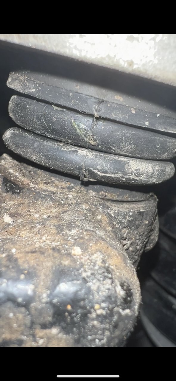

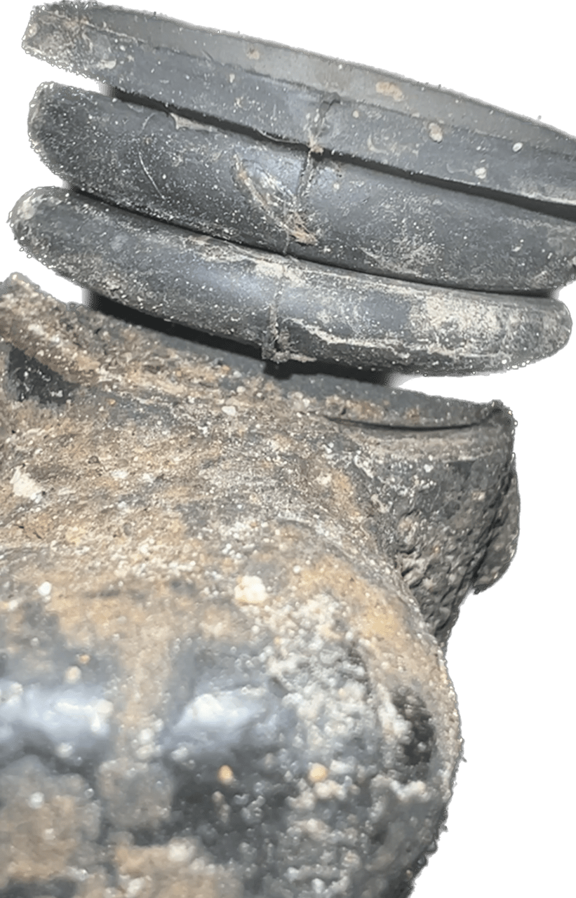

    Zoom in, this is the outside of the boot

    Okay, so it is the entire rubber boot. Yep. either you are exposing them to something they don't like or you just got a crappy BJ.

    Maybe just being in direct sunlight all day IDK, but that crappy if it can’t handle that. My SPC arm bushings were junk but at least the boots were quality. Don’t get me wrong I like the RC arms, I just have bad luck I suppose
