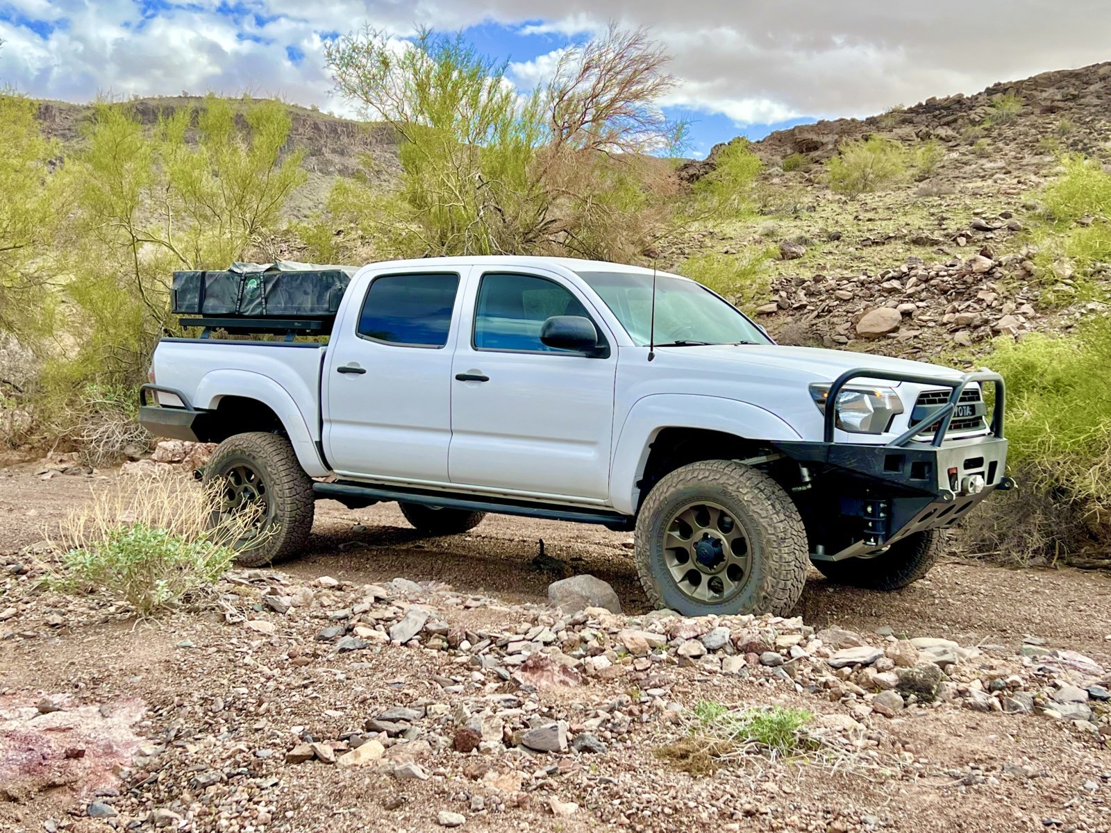

    @backcountryj I have the RC control arms. I just purchased them through poly performance because they had the price. Have had them installed for about 8 months now and so far so good. Just got back from a trip and did about 100 miles of mixed dirt washboard roads and mild rock obstacles where 4wd was needed. No issues, everything aligned fine. I’m running ADS reservoir coilovers set around 2.75in of lift, 255/80 falken at3w on FJ wheels with a 1in spacer.

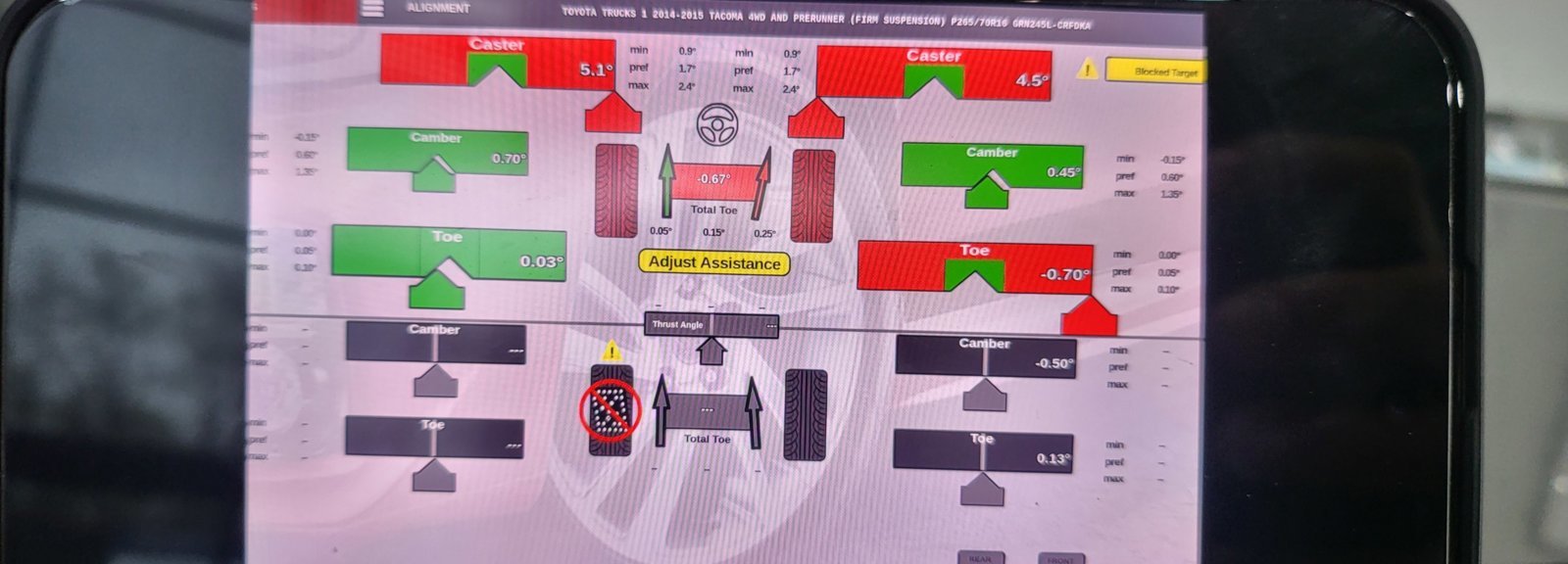

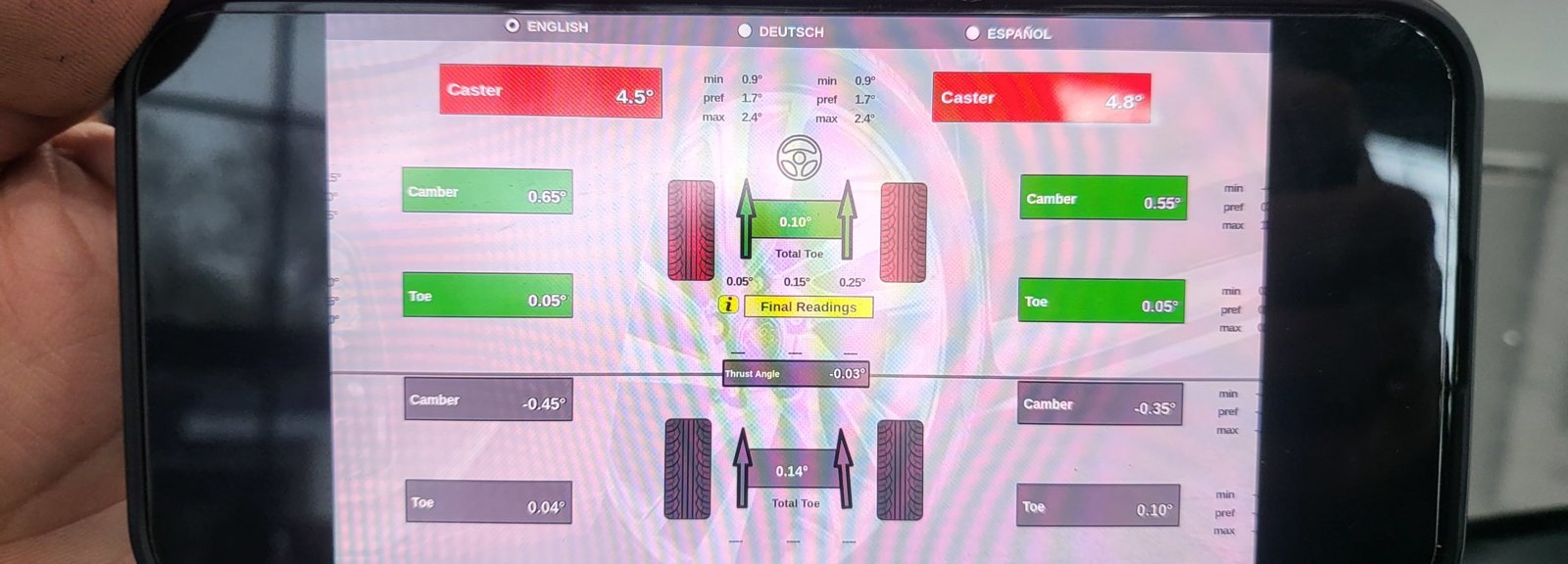

    Well...picked these up before seeing this thread. Let's see how long these last. Mostly on pavement with occasional dirt roads for campgrounds and lite OR. Eibach kit set at 2.75 lift up front and 1.75 w/ AAl with 275/70/17. Alignment results..before and after.
