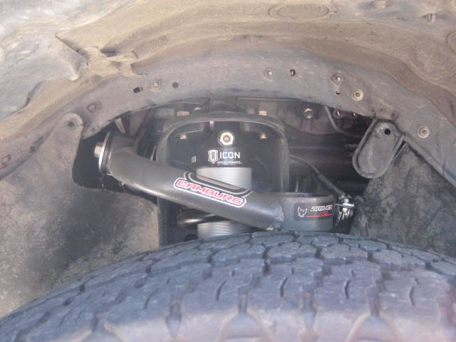

    i just bought the icon stage 2 system also. i went with the camburg uca's, but i just got the ball joint ones. seem to work just fine. im very happy with everything!
