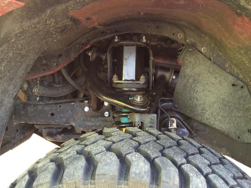

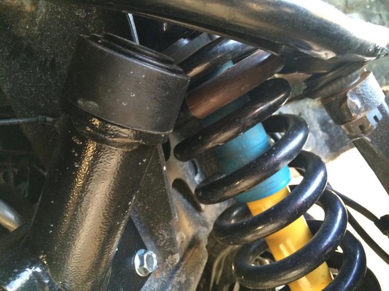

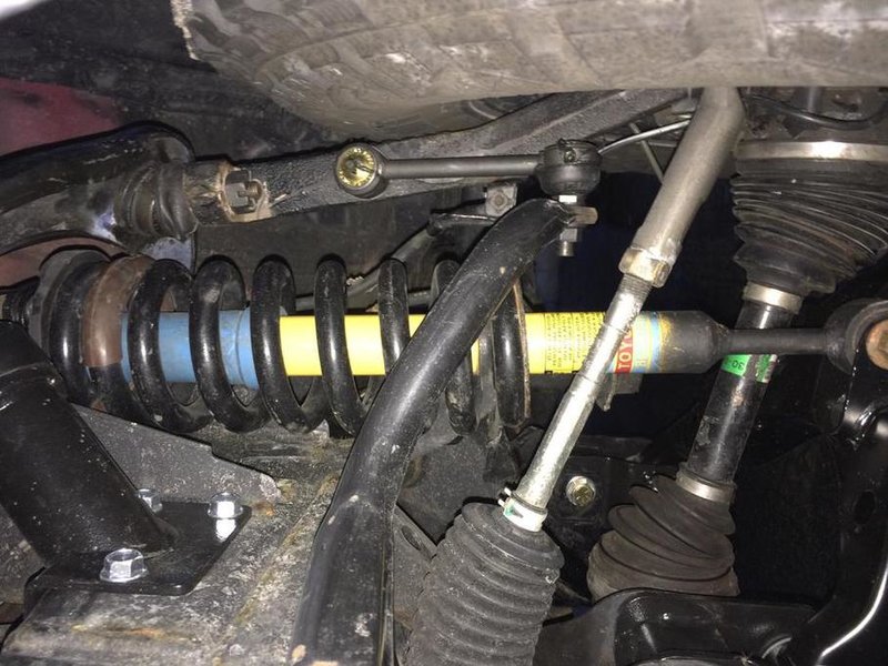

    The 999 is the rough country
    http://www.**************.com/index...iVprlr5F_8hjgEIdbDpTXLwZiNKrOAKXs8aAjOI8P8HAQ
    And this is how bad the rc lift is. Look at the cv angles and look at the tie rod angles. They also don't make the spindle long enough which causes the severe angle on the uca and balljoint. Now compare this to the rcd, procomp, zone or bds. So if you want to pay 1k for this go right ahead but I wouldn't waste my money on it.

    Don't know why rc came up under pro comp search, I stand corrected. Well 600 is still a bit much for -1.5in and struts IMO

    the point that is being overlooked here is db lifts keep your cv angles and steering geometry good. get a nice coilover lift crank it to 3" and see what the cv and upper ball joint angles look like. u have no downtravel left, its like walking on your tippy toes.

    You do drop your diff a bit but DB lifts still give some pretty steep angles with the 6" lifts

    Wrong! Only on the rc lift has the poor design which gives you steep angles.
