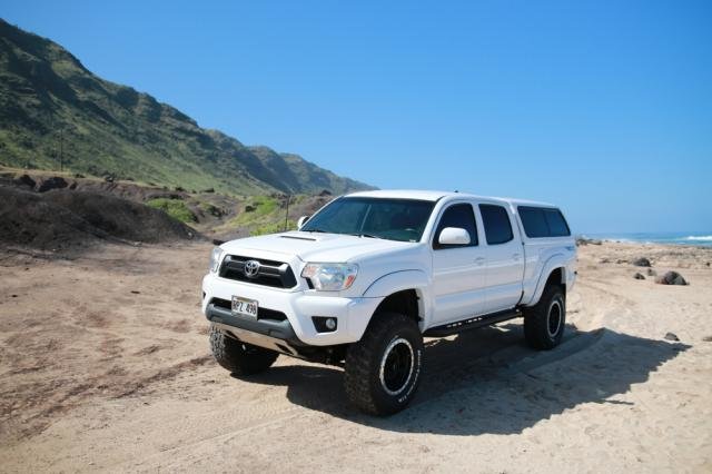

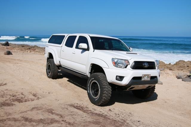

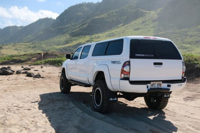

    Got to finally test the RCD lift with a little light offroading today:D

    I haven't seen mentioned anywhere:
    Drop bracket lifts force a sacrifice of IFS skid plate. People should be aware of this if their truck will see anything beyond dirt roading. You will also gain breakover angle but have less running clearance than a truck with a 2-4" suspension lift without a drop bracket.
    Rear blocks can potentially have a deleterious effect on leaf spring life and axle wrap.
    Lifting this height will in many cases necessitate addressing the carrier bearing in some fashion. People should also fully cycle their suspension and check for adequate rear brake line length.
    "Best" lift? It's very hard to determine a "best" item without specifying goals first. RCD's 4.5" option is fine for on-road and dirt-road use, however forces considerable sacrifices for other applications. Caveat emptor.
