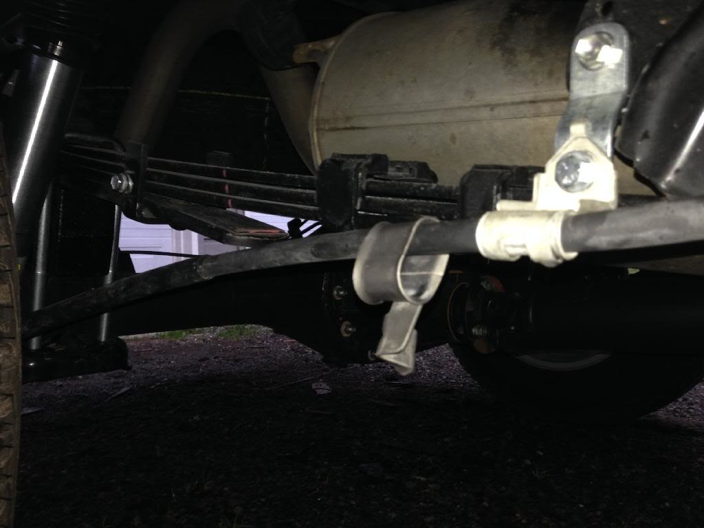

    Okay guys! Could you please help me out on a question?? I did the rear portion of the lift last night and everything seems perfect with only one issue.
    There is a drop bracket for the rear parking brake line on the front mount pictured but what am I supposed to do with the rear one that attaches to the leaf spring? I couldn't find any answers in the instructions.
    Thanks for any help!

    I cut mine off.

    That's what I was thinking, it doesn't look like it could come close enough to the tire. Just weird that they make no mention of it. Everything else so far has gone really smooth. Anything I should watch out for on the front?

    I scratched my head on that too. After attaching the included drop bracket, I wiggled the brake cable around and it didn't make contact with anything, so I just cut the hanging bracket off.
    I take it you haven't started the front yet? That's the fun part! ;)
