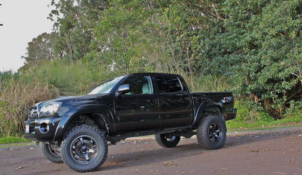

    Looks sick man, how much was it for all the lift components? worth the extra cash over a 3 inch lift?

    2010 Magnetic Grey DC Long Bed TRD Sport 4x4
    RCD 4.5" Lift ,Moded to 5.5",1.5 inch Toytec AAL Light Raceing UCA's, 285/70/17 Duratracks, Procomp 7028 Wheels 17X8.5x4.75, Leer XQ Shell,Keyless Entry,Bedrug, Kartec Front End Limiting Straps.
    absolutely worth the up grade over the 3inch kits,as it now rides in the factory location,
    now you can get away with 2inchs ,maybe 2.5,but not 3 with out a harsh ride over bumps,cause at 3inchs you have very little down travel left,
    kit runs for about $1900,install was $450, $69 for alignment

    ^bummer.... I'd recommend any DB lift for those who don't Offroad hardcore...
    and if you did offroad then I recommend a LT kit... everything else is mediocre

    Man, that looks bad arse!
    Do the stock skid plates bolt up with this lift? I have the TRD aftermarket (silver) one in place too and would like to keep all of them.

    no the trd won't work

    ya i tried to make my trd fit but i couldn't think of anyway to make it fit. i did get the stock skid plate to fit though. just some minor cutting.

    ^haha...the stock black one does fit with some modification

    Nice job on the lift and mod. It looks like you kept the 4 inch block in the rear and added an additional inch or more to the front suspension only. Were you going for a more leveled look to the lift, or were you wanting more clearance?
    I am looking at getting the RCD in a few months, but I want to retain the leveled look given by my current 3" spacer lift. With the RCD I was thinking of using a 3" block in the rear to level it a bit...or, after seeing your mod, I may use the spacers up front.
    My truck is black as well, great choice of color and mods!

    the rcd kit sits fairly level. mine doesnt because i have an aal in mine because i carry around my street bike and dirt bike around ofter.

    I am about to get the rcd kit. Anyone recomend a spacer up front to level out the leaning down? If so where can i get one and what do you recomend? Does it affect the ride any doin this?

    Save your money and maybe order some custom fox or icon coilovers to go with this kit.
    Please read: http://www.tacomaworld.com/forum/2nd-gen-tacomas/166828-quick-spacer-lift-question.html
    The rake is RCD's signature for our Tacomas!
