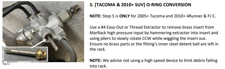

    Did you remove the brass fitting in the rack? Here is the step in the instructions I am referring to:
    I left this fitting in and made a new line to use the correct fitting into the LC 200 Rack

    If you haven't replaced your PS pump yet, if you call up JD Fab for their Howe PS pump kit, you can tell them you have the LC 200 rack and they can supply you with the lines and fittings to go right into the LC 200 rack with out needing to modify any fittings.
