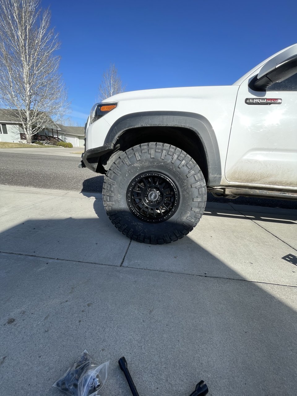

    fair enough. The rack does require fab work, I could not do myself, I am not a welder… yet
    All I can say about the “1 ton” rack setup is that it’s pretty darn close. One ton setups break all the time on jeeps. I really wish there was something quantifiable, I do see your point.
    the RCLT does allow for larger tires. I looked at putting 35s on before RCLT was chosen. In order to be “completely functional” I would of had to completely chop my front … everything up. With RCLT I have hammered top pinch weld and trimmed my fenders and bobbed my SSO bumper. (Most modern have better Offroad bumpers anyway). For reference, I’ve attached a photo of my 37” mounted and installed with my stock geometry… aftermarket UCA and fox 2.5 with dsc.. but stock geometry. I could not even turn the wheel 5° either way. The firewall needed 4” of tubbing, I can’t even begin to explain the room that was left inner side. RCLT took care of 90% of my 37” problems. It isn’t perfect. The things that need attention are owner and vehicle specific. There is A LOT of customizable options. Yes, I spent some silly money, No it isn’t perfect. Maybe the marketing could tone down and a mild amount of verbiage change for “different level of build”, but for the most part I got what I paid for.
