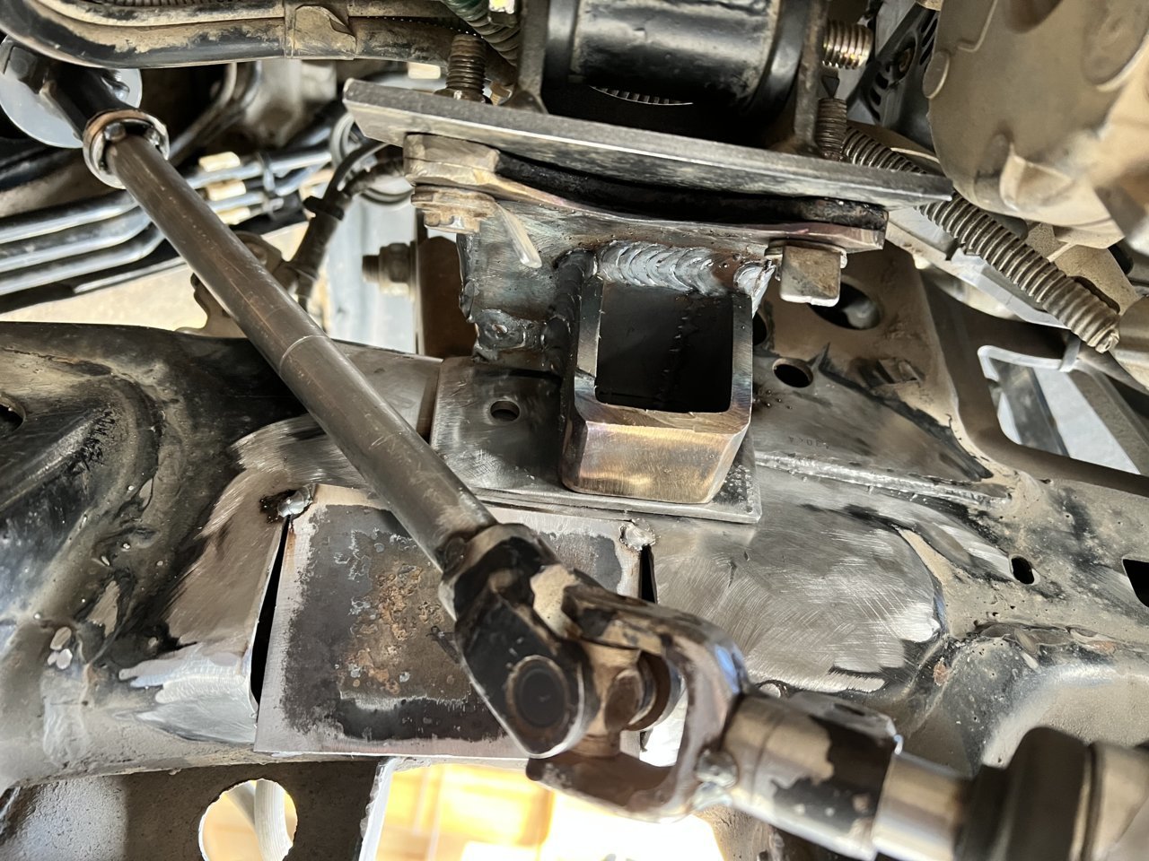

    Yeah, you got cut the frame up, that shaft is looking pretty slim. Here's what I did to get the Tundra rack to fit, mounted in the same place as the "marack" using the diff mounts.

    Nice work. Looks like you have a lot of room in there. Was your engine out?

    Ha, no, but the motor mount was, it was in the way as well :sawzall:

    Did you weld in a new mount? Makes sense to do it your way. We did all the gusseting while waiting for the RCLT, replaced the engine and trans mounts... then had to go remove a bunch of that.

    Yep, took the stock one and hacked it up.
