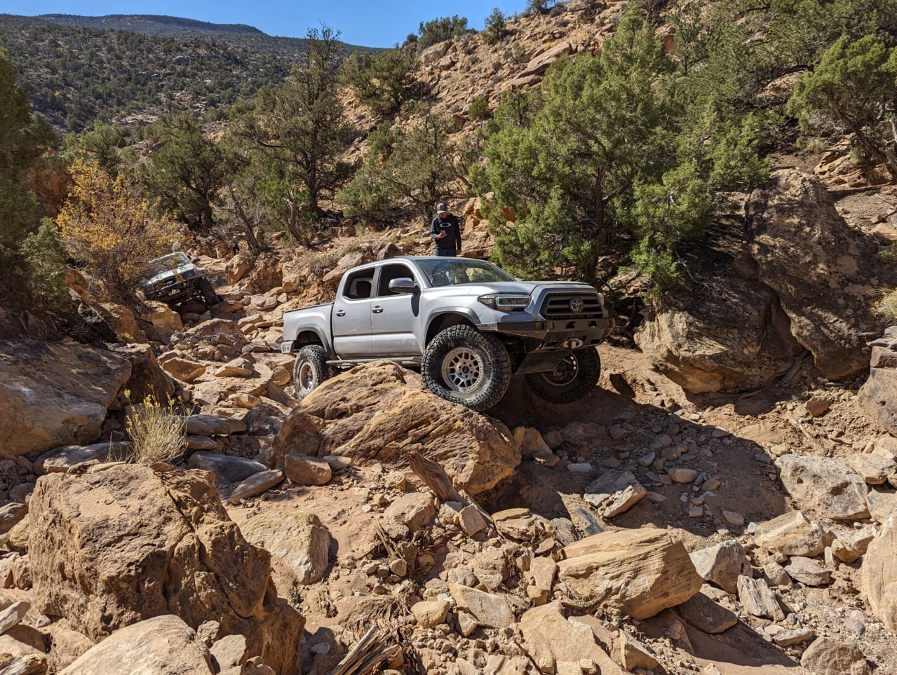

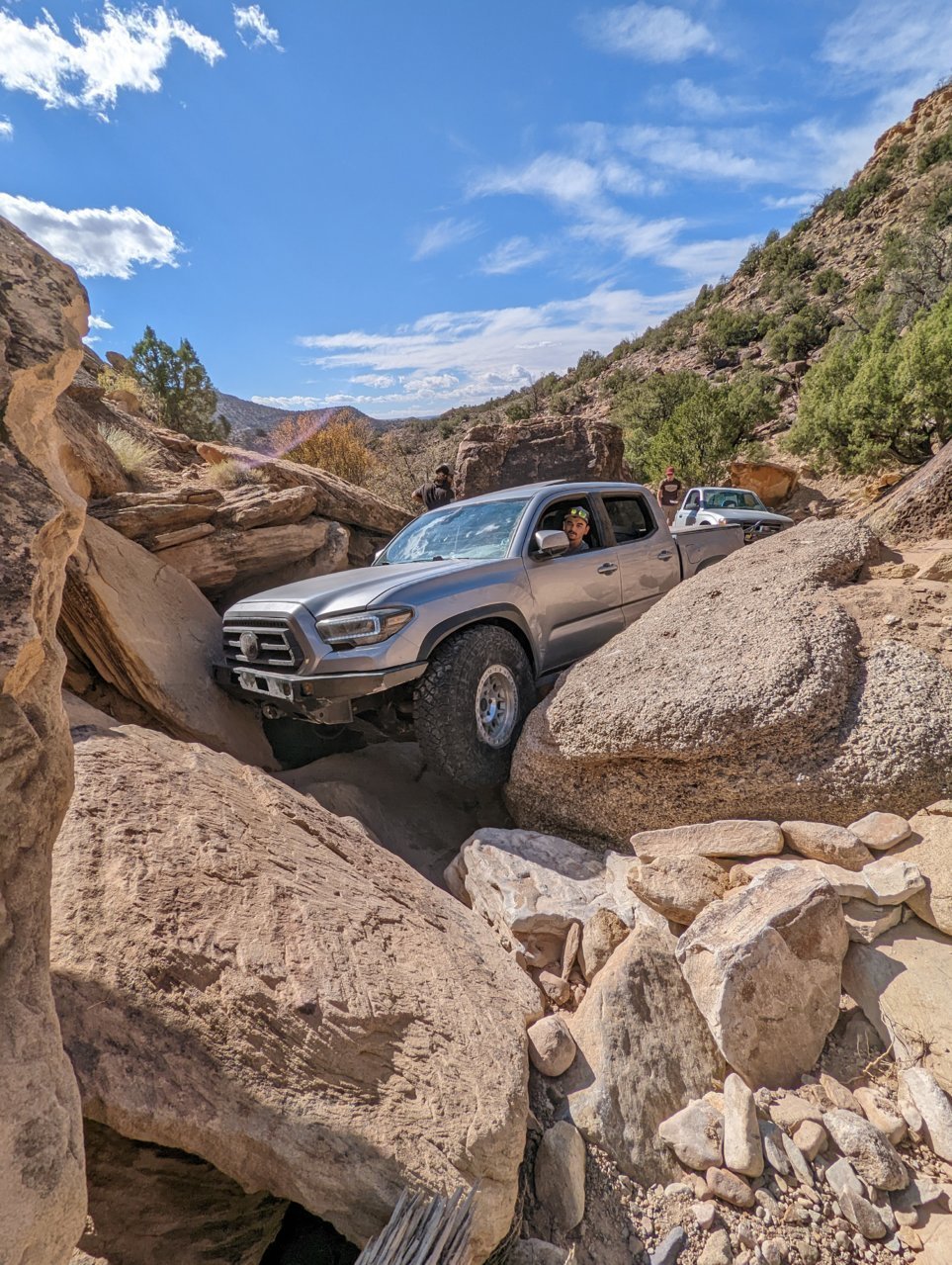

    Totally with ya on all that, but I do have slight confidence in Ifs at times as I'm "that guy that hasnt broke yet". Im still factory cvs, regular tie rods, add tube, diff, etc. Havent been able to break anything with 35s/37s over the last 2 years. Just did the Tundra rack for half ass piece of mind as I drive mine to/from places in the country, but couldn't blow up/break my oem one although it was leaking a bit from higher mileage/constant wheeling.
    Group of us did Coyote Canyon and Pritchett in Moab this weekend. On Coyote, my truck has never been so constantly and royaly fawked/bound up/wedged, etc. This is with the factory Cv's that have been clicking/popping for a year.
    I was hanging from the wheel the whole time, as my stock pump is finally toast. Otherwise I'm impressed, but yeah others that I know wheel hard have worse luck at times. But, everything is upgradeable or easily fixed in minutes.
    In the end I am throwing an axle under the front if I decide to keep this truck.

    Are those pics coyote canyon? I haven’t done any good trails in Moab since helldorado was brand new. My ps pump kicked it near the start of that trail. I was toast afterwards.

    Yeah that was Coyote, which I spent most of the day on winch and did some good damage to my junk. Definitely not a 4 door tacoma trail unless you either dont care about body, or have a 25+" frame height/tires fully outside the wheel well.

    Yeah that second pic looks a tad tight.
