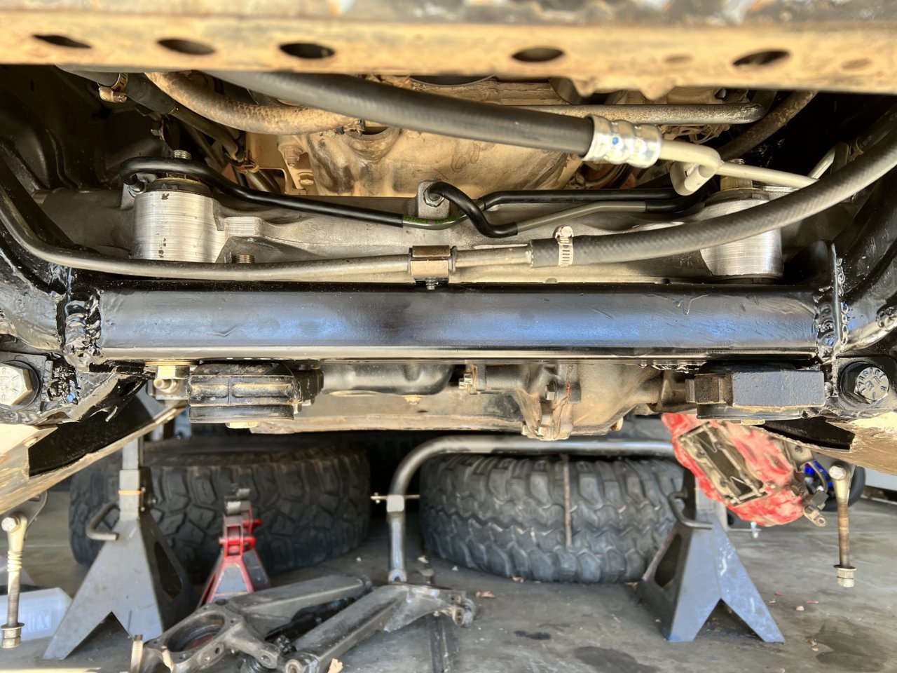

    Check.

    Very clean solution! How long did that take you?

    Too long, like every custom fab project, maybe 4 weekends to get everything dialed and burned in. That includes the provisions for mounting the Tundra rack in as near of the stock location as possible, which took a bit to figure out. I also had an intermediate step of fileting the stock member, which I bailed on in favor of this version, that cost me a weekend.

    Damn, looks like a big undertaking. Pretty bummed Marlin didnt include a solution to this with their "kit" so it could have all been done at the same time. Kinda like we are guinea pigs on this.

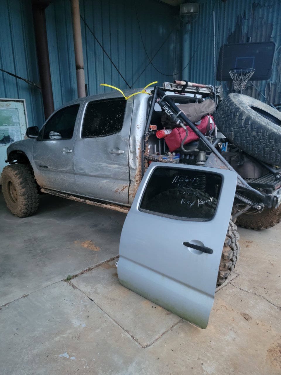

    Idk, no one wanted the raisined truck I just sold @Snowy. Hell, he’s trying to un-raisin it currently. Replaced both front fenders and trying to find bedsides now.
