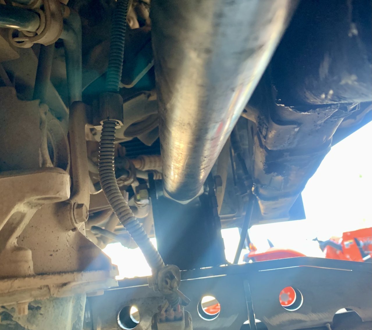

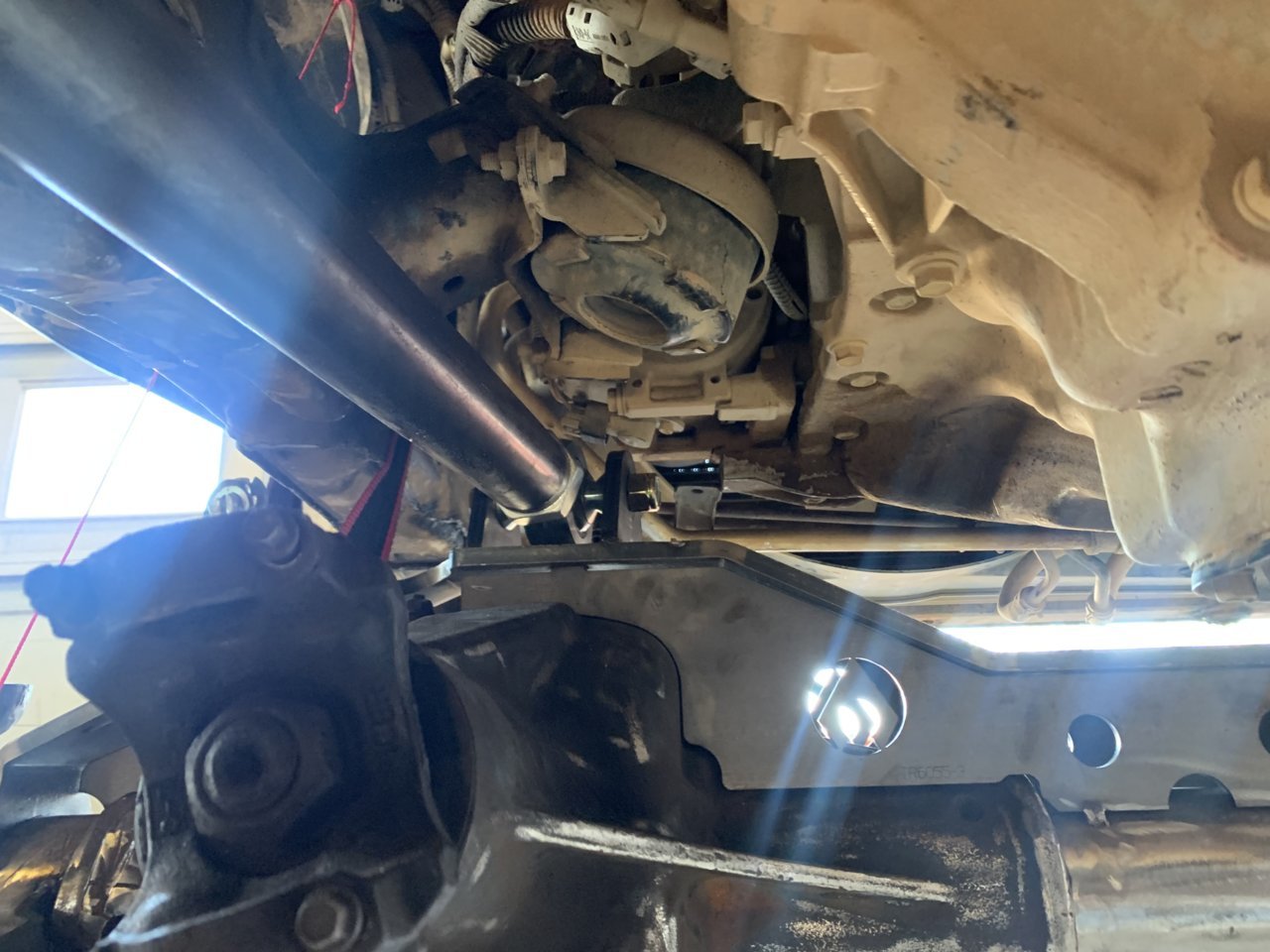

    How’d you raise your engine? Been debating doing that for a bit more uptravel, but not sure it’s worth the trouble.
