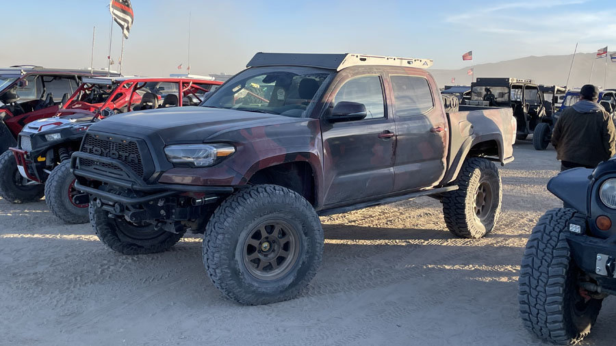

    Hey WormSquirts, thanks for the reply! Sure, that's no problem at all.
    38x12.50R17 Milestar Patagonia M/T using our MCSU-761 Low Profile Bump Stops. Truck lives in Washington State, very friendly owner and happy to show it to ya in person :thumbsup:
    You can just barely see our Low Profile Bump Stop below the factory frame mount. Body mount 100% untouched and with factory paint. Spot weld seam on cab was hammered over flat.
    Kit is broken in and achieves our full 32° of turning angle (64° sweep, which is 4° more than stock -- see FAQ for steering angle measurement table).
    Runs full stuff up to our bump stops, now calculated to be 11" of travel, with no rubbing.

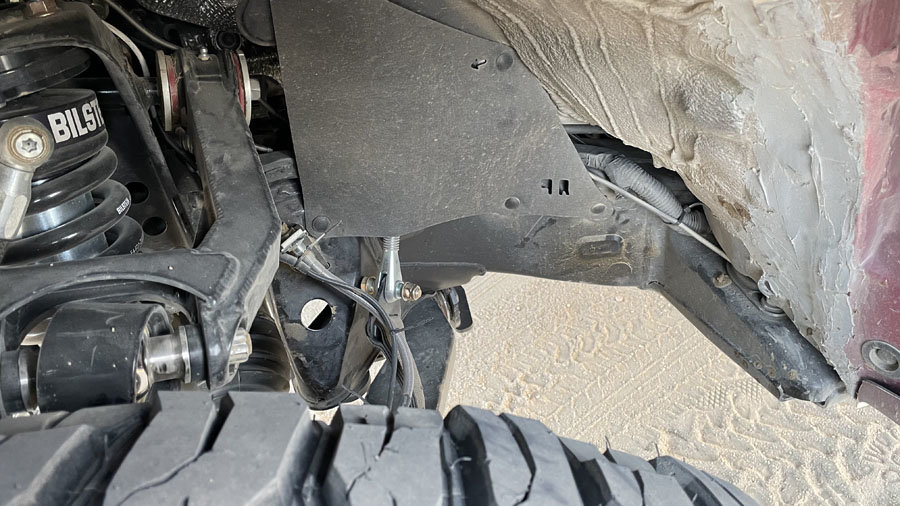

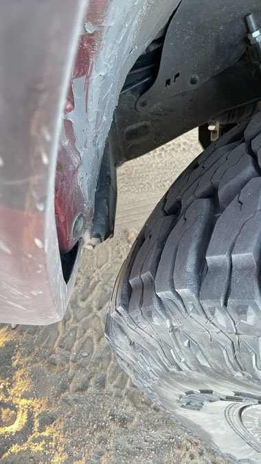

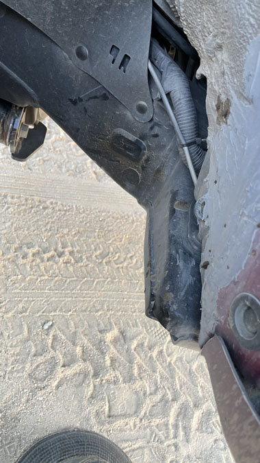

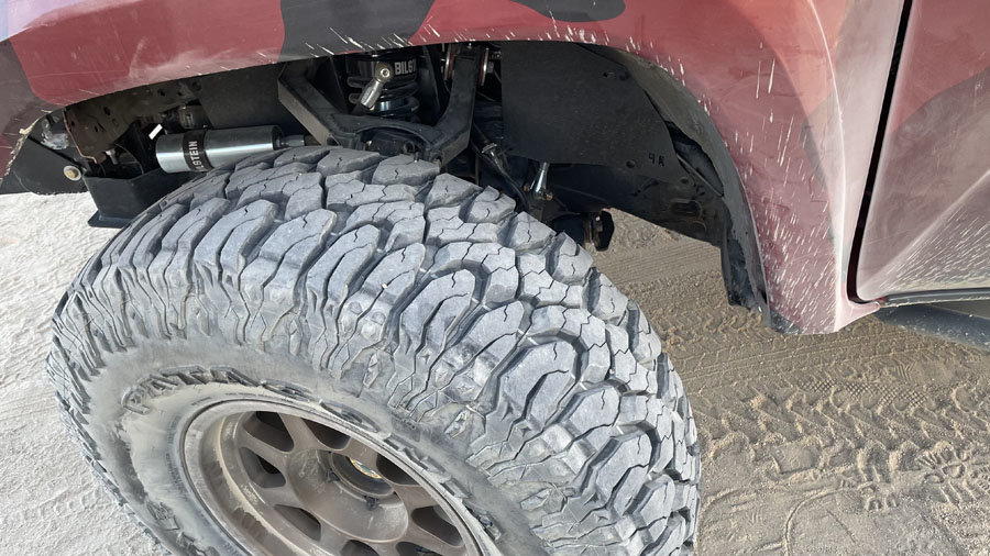

    BC
    Any pictures of the inner wheel well with the wheel fully stuffed and turned to lock. Especially below the battery/washer fluid reservoir?

    Will request pics :thumbsup: Also, I am planning a Canada snow wheeling trip and will pass near the rig and can see about getting pics myself!
    For the sake of argument, I’ve edited my reply to say, “very minimal or at best no frame or body trimming”.
