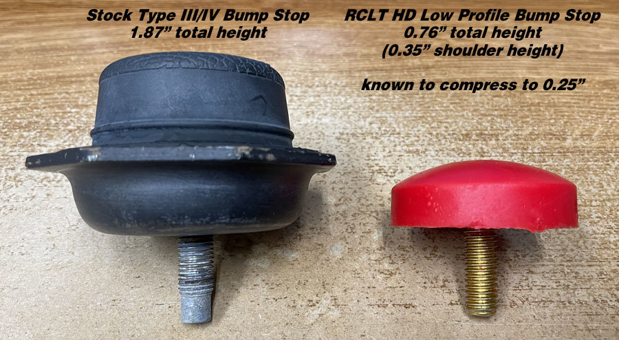

    There is a lot to unpack here so let me break it down little by little:
    Yes - This was installed by my shop on my customer's truck. GD Motorsports - you can message me here or DM me on Instagram, and I am happy to talk to anyone about it. Instagram: kyle_GDMotorsports https://www.instagram.com/kyle_gdmotorsports/
    Let's start with the "glaring issue of bump stop". As you pictured above, a small bump stop is provided because of the "inverted" lower control arm. The design of the control arm does shorten the distance between the bump stop and the LCA - therefore I do understand why you include this bump stop. Because I was installing this on a customer's truck and I have to stand by my work and reputation - I was not and am not comfortable installing a 0.75" bump stop on a customer's vehicle. I will not do it for a couple reasons: 1) you said above that the bump stop is known to compress down to 0.25". This means there is 0.50" of poly between your truck bottoming out confroably and blowing past the bump stop and pushing the mount into an already thin-walled frame. 2) the bump stop is moved further inboard towards the frame, thus resulting in greater mechanical force being transferred into the frame to catch the truck. This does at the same time reduce the leverage point as it is closer to the frame. so this point is probably a net wash. more load+less leverage being closer to the frame = net wash.
    Now the final decision not to use the provided tiny bump stop was true because of my concern about the frame buckling because of the lack of damping. Instead, I cut the bump stop mount off and replaced it with energy suspension universal bump stops. In doing so, I was able to add 3/16" frame platting to help spread the load to prevent the frame from buckling. Now - if you use this kit strictly for slow pace crawling, this provided small bump stop would probably never give you issues. However, as the installer, I feel a responsibility to make sure I install it to the best of my knowledge that reduces every risk I can of the customer damaging his truck. I also believe that if you are spending money on long travel - we all will push the truck hard and fast at one point or another.
    Travel Numbers: "I get 10.98" of travel [11.875 + (0.25 - 0) * (8.75 - 11.875) / (0.875 - 0) = 10.982..."
    I don't follow your math and nor do I care to. two things changed: compressed bump-stop height and the location of the bump stop. So the only way to properly give a true hub travel number would be to install it and cycle it. I should have done this step but did not. I also do not care about this number because I really feel that the small bump stop provided in the kit is a huge liability. I will never ever recommend someone use it - EVER. Stick with the OEM style bump stop if you choose not to cut your bump stop mounts off. Therefore 8.75" of safe travel.
    As I am sure everyone who has read my rant on the bump stops this far has asked the question, "why did you not put hydro bump stops on the truck?". I did not do this for two reasons. 1) they are terribly loud when they are engaged, and for anyone recreational off-roading, this is an irritation. 2) because of the inherent flaws with bump stops on the lower control arms is the fact that they would be engaged for almost 4-5" of wheel up travel. This is pretty close to 40% of the total wheel travel available. Not ideal. The ideal solution is to do an engine cage with a bump stop off the upper control arm/splindle. This kit would be a perfect candidate - this it just comes with a healthy price tag. After the customer had already spent a grundle of money on the kit plus labor to install, spending another stack of cash for this was not high on the list of priorities and understandably so.
    As for your explanation for the reason behind the TRE angle - I do not agree with this. There was uptravel left on the table for the product that is currently available. Instead you alluded that you designed it this way for a product that is still in development. Which to me means, it may or may not ever come to the market. So I still stand by my statement of wishing it was designed around working CV angles from Bump to strap. Meaning that there is travel left on the table. This now segments into the next topic:
    Tire Size: this customer ended up with a BFG 37x12.5R17. Which we all know run smaller than other 37" tires. That being said, I still had to cut and modify the JD Fab inner fenders behind the headlight. With the current TRE angle hitting bind, there is less up travel than other kits. This does make fitting larger tires easier because the tire does not travel up into the inner fender nearly as much as other options on the market. ALSO MEANS This kit limits travel to clear large tires. This point has been argued time and time again. But the fact is, if you have cut less sheet metal then the kit inherently has less up travel. Plain and simple. I am not going to argue this point anymore. I have put 37s on MANY Toyotas at this point, and I know how much it takes to cut sheet metal out of the way to clear the tire without rubbing while using all the travel you can. There is no reason to limit performance because you don't want to cut sheet metal - that is just my opinion and they way I set up customers' trucks. They have spent all this money on good suspension to gain all the travel possible, then turning around and putting bump stop spacers is just idiotic to me. Or spending an ass ton of money on a long travel kit that has poor TRE angles because you have an idea for a product that may or may not ever hit the market. I don't understand this reason. This kit should cycle and performance was left on the table.
    As for you talking about drooping the tire out more - well it just cannot be done because you are already at CV bind on the droop so regardless - your statement of "So while having a lot of flex is nice, if your caster, camber, and toe goes wonky each time you drop or stuff a tire beyond what Toyota intended..." is completely irrelevant. So I'm not even sure what you mean by a product that could come on the market to use the rest of the current TRE angle... unless you drop the diff lower to achieve more droop. Now, this is all turning into speculation so I will stop here with it.
    My original post was simply to put the numbers and not be biased one way or the other. after this response, I think my opinions are a little more known now. The build quality is top notch. the strength is unmatched and there are many, many positive things to stay about this kit. I'll leave it up to everyone else to make their own decision if they feel that the price tag is worth it compared to other kits on the market.

    Good morning (when I began typing :D), thanks for the discussion. Criticism is deserved and noted. I have spoken to many customers who upgraded from 285s to 37s without any additional trimming, which is why I am quick to say things that prior to RCLT HD was not possible. But the thread is correct that if someone adds RCLT HD to a stock vehicle, reuses stock coil overs, etc, and proceeds to install 37s, then yes sheet metal and plastic trimming will be required ... but not any frame metal. Therefore, the claims on our website are 100% accurate.
