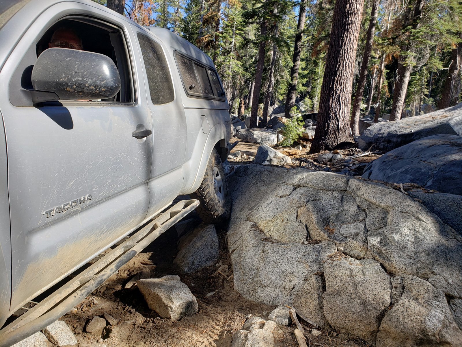

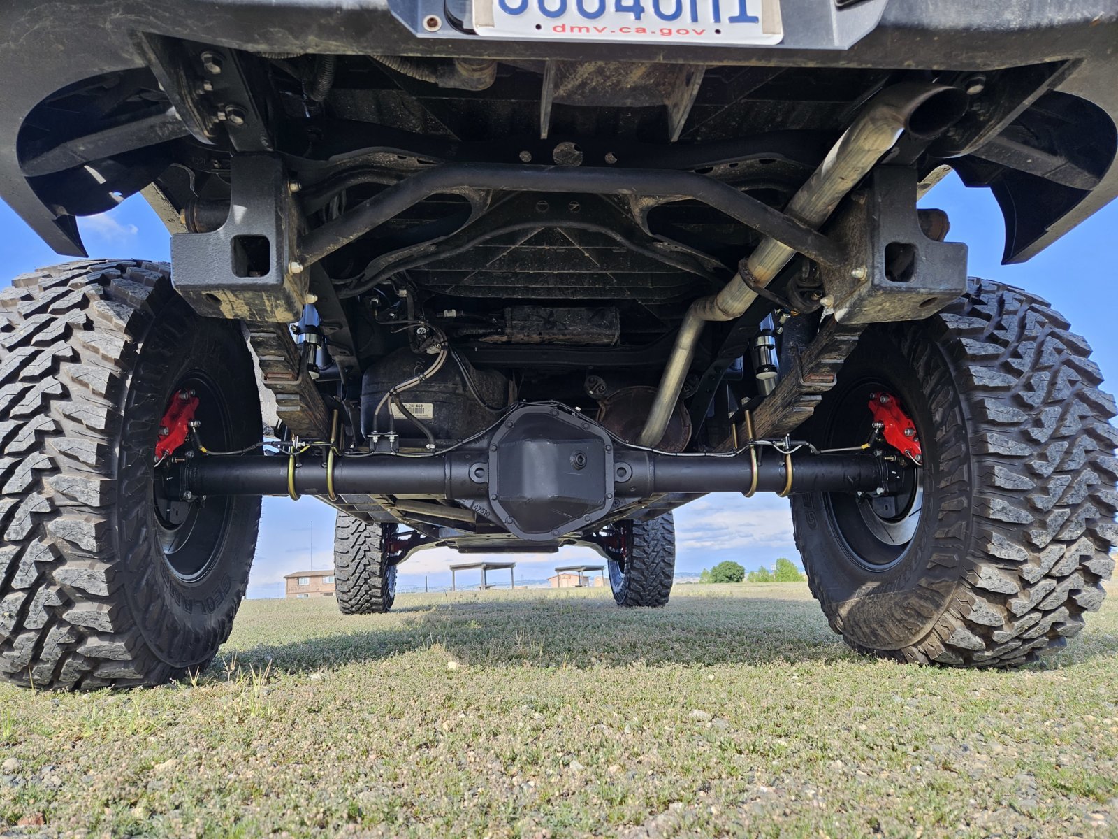

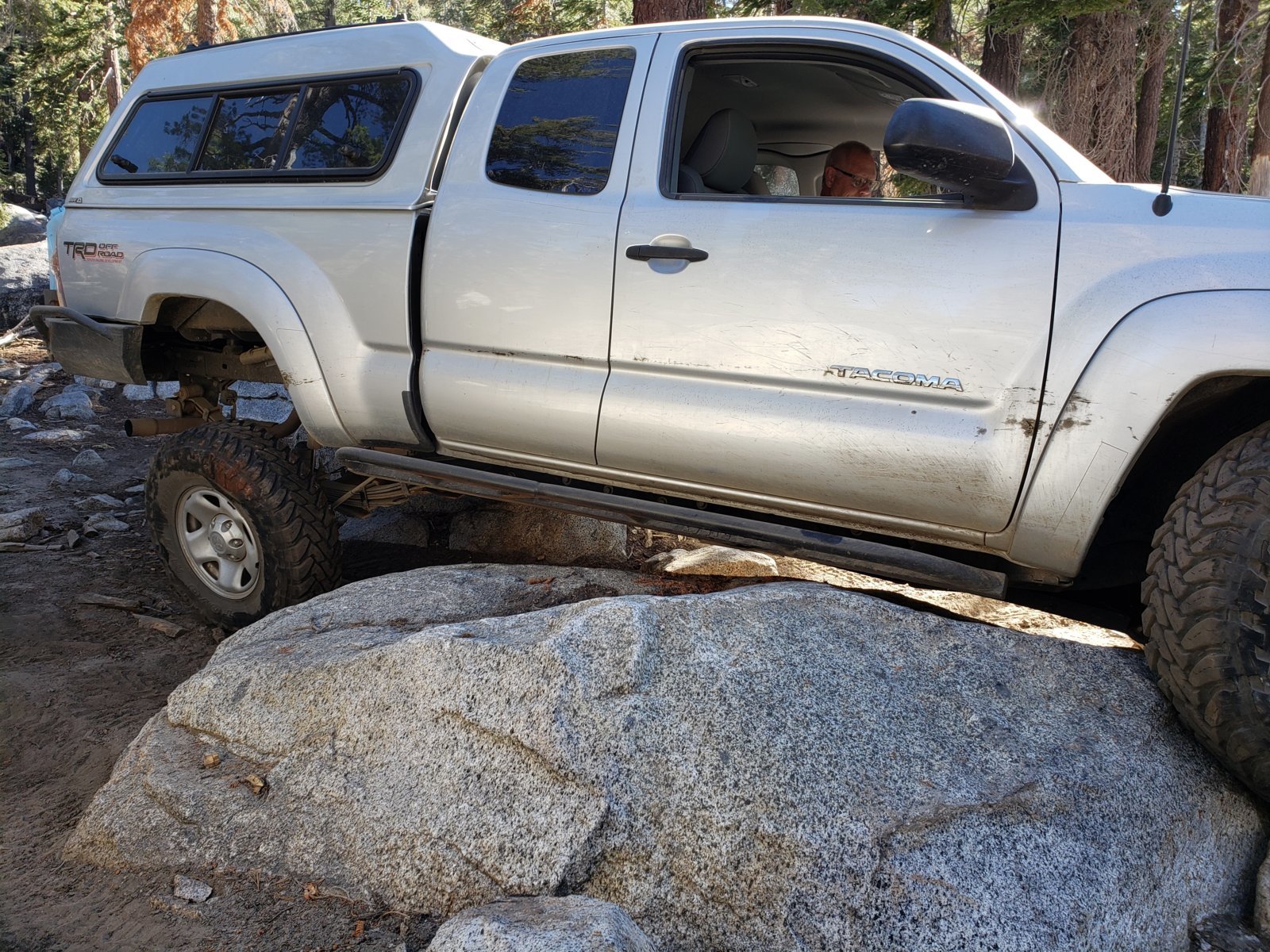

    My soa is doing just fine with my setup.
    Got plenty of travel and clearance.
    Ride is awesome.

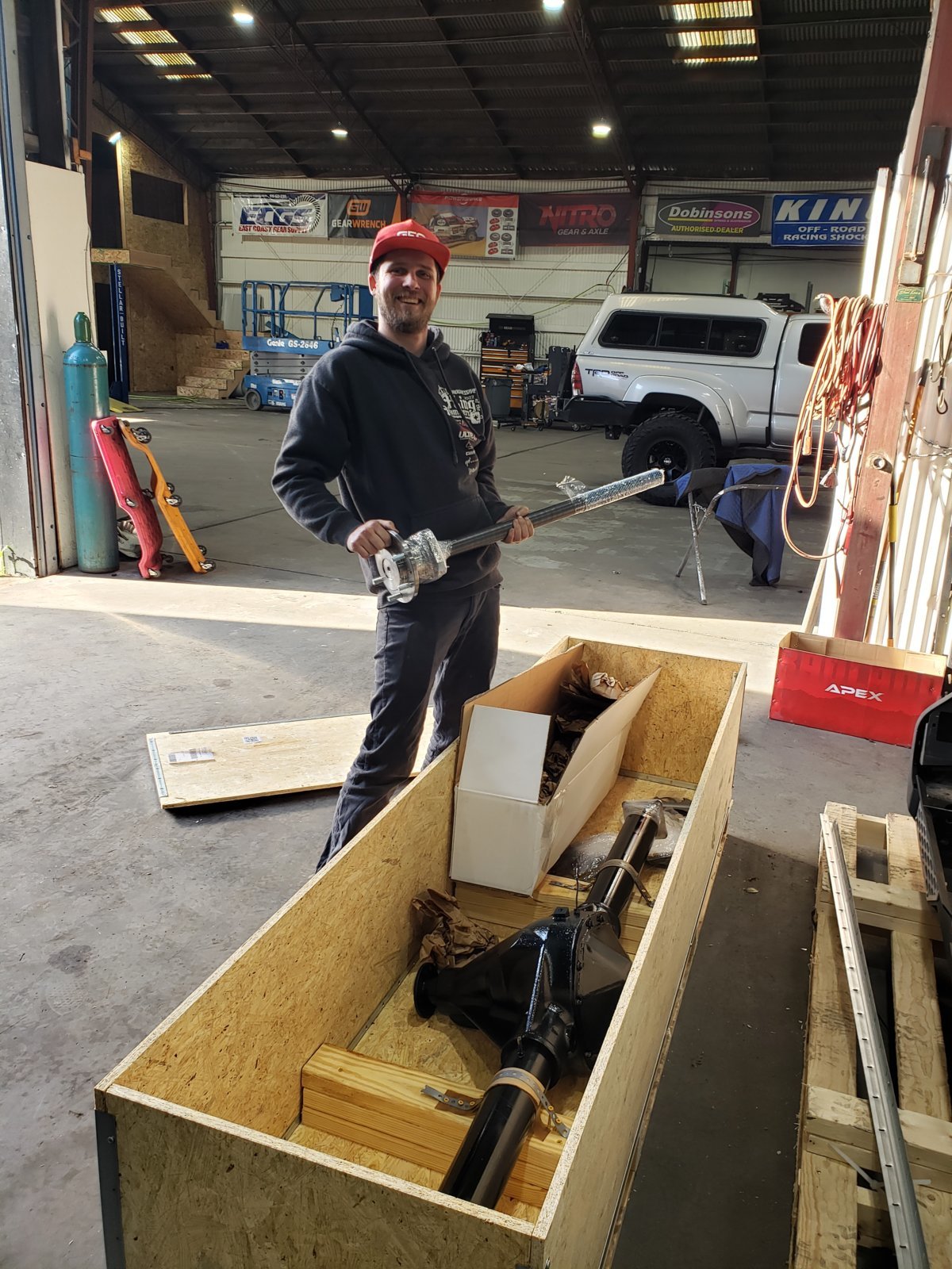

    40 spline baby :benchpress:
