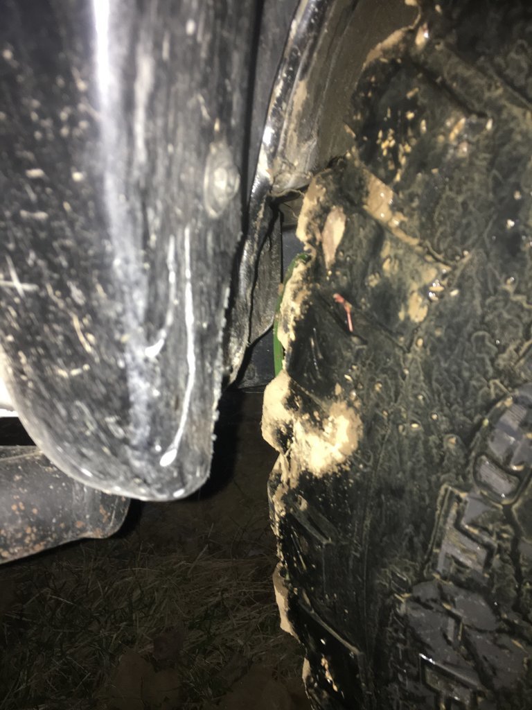

    I'm going to have very little time to work on the truck between now and AOP, so I was way more concerned with getting the caster up than the camber for this alignment. Told him to give me as much caster as possible without going more negative than one degree. I'd say he nailed it. Ha ha.
    Once I check clearance, I might have him dial the caster back a bit to get the camber back closer to 0.
    @Squeaky Penguin is this about on par with what you were expecting to see?

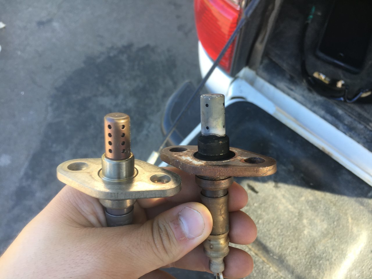

    Got a new O2 sensor. Pulled the old one and realized they gave me the wrong one. :annoyed:
    Another trip to town and some arguing later, got the right one with a little discount. No more CEL.

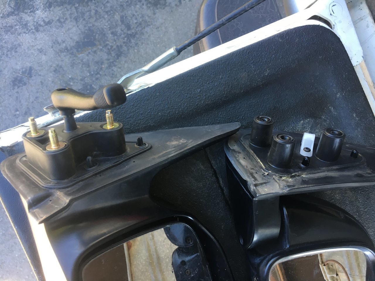

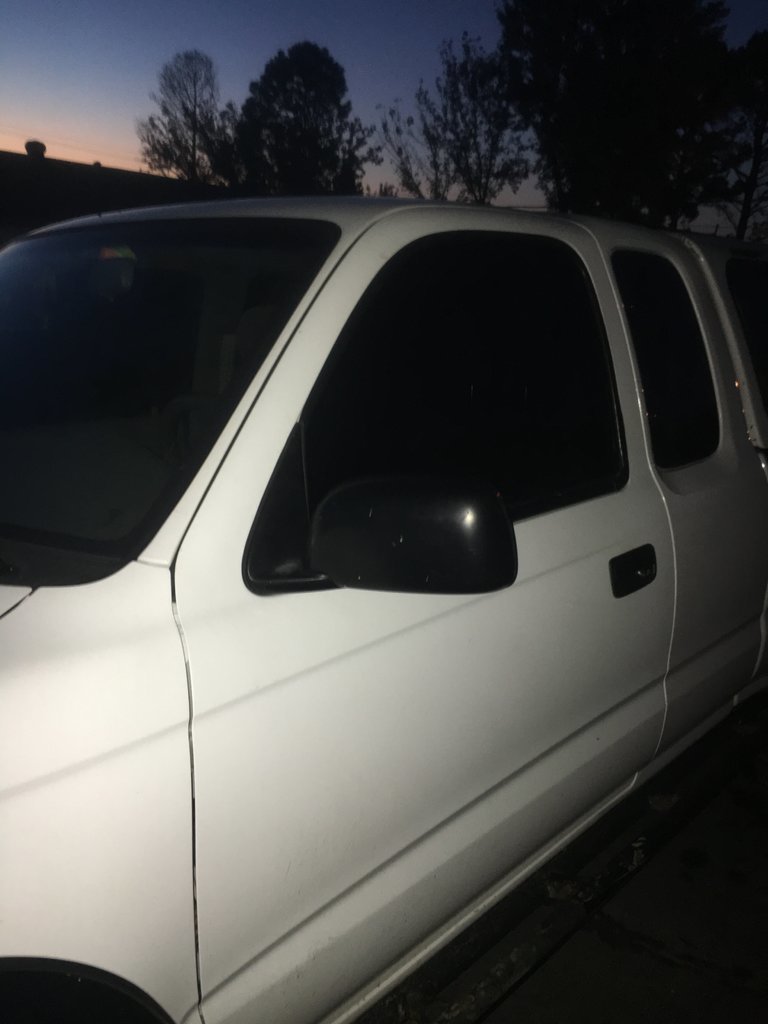

    Got a set of folding mirrors from another member. Now I can be super duper skinny. This type mirror mounts a little differently. Had to pick up some M6 bolts and it fit like a glove. You can see the difference.

    That's exactly what I expected. The negative camber allows for more caster in the LCA adjustment, getting you more room at the firewall.
    Should turn awesome too, and have minimal tire wear.
