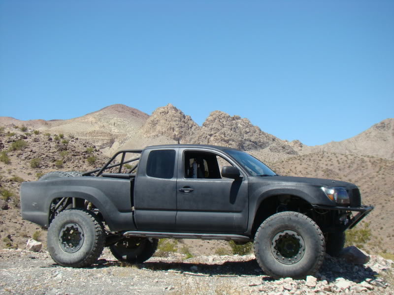

    5.29 is possible in the rear diff only, so if you are a pre-runner then you can do 5.29's, if 4wd then you have to get 4.88's. I believe I am running Nitro gears. I bought assembled diffs from East Coast Gear Supply.
    About racing, I would talk with MJP2. He used to race his Tacoma. Username could probably help you out too. I don't think he ever raced his, but it is built for it and he beats on his rig hard!
    MJP2
    Build thread: http://www.tacomaworld.com/forum/2nd-gen-builds/17641-mjp2s-build.html
    Username:
    Build thread: http://www.tacomaworld.com/forum/2nd-gen-builds/233960-project-apocalypto.html
