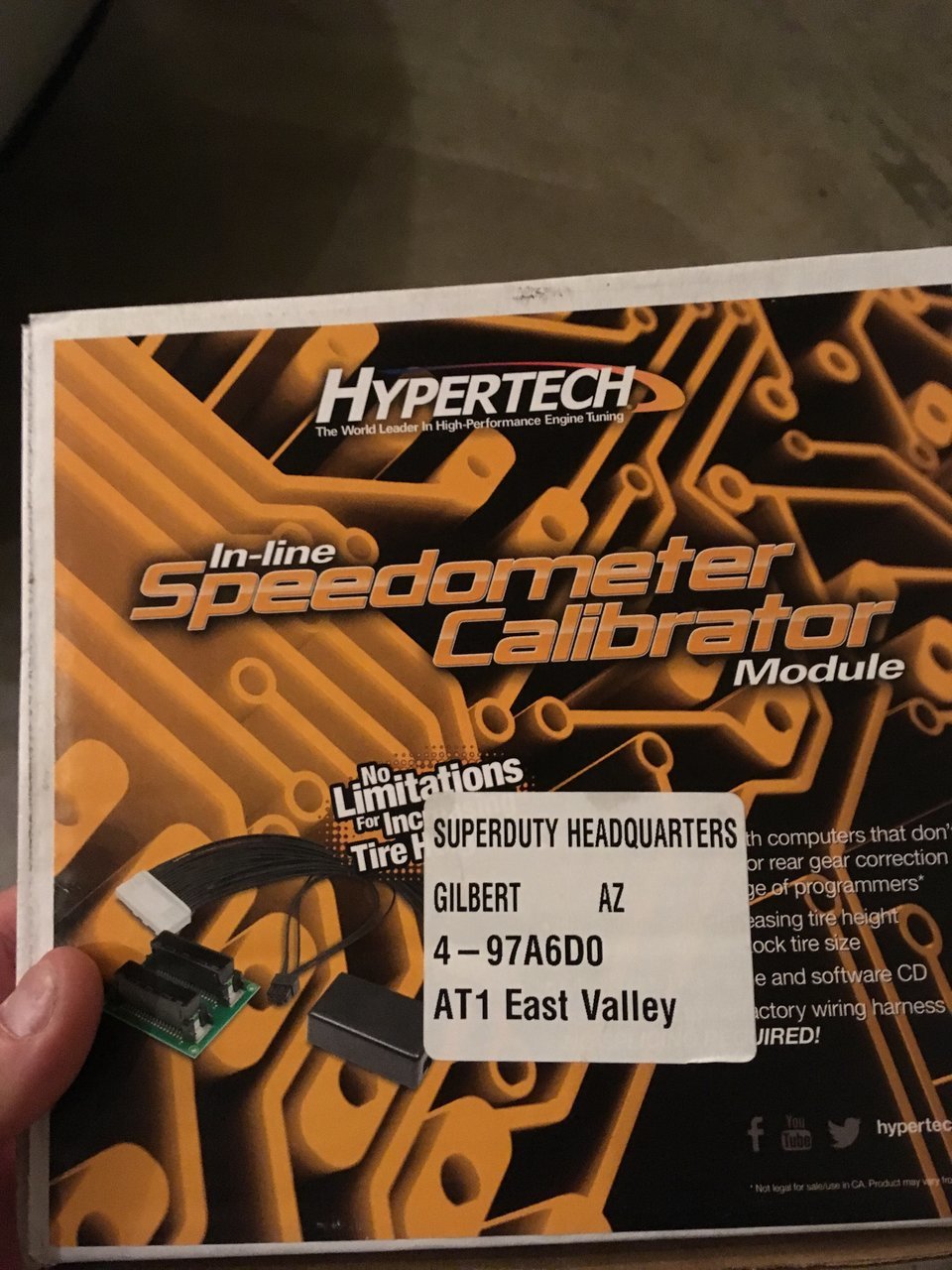

    After new gears, did you re-calibrate your Center cluster speedometer (if that is even possible)?

    No, I just ran waze on my phone to figure out my speed. Now I know at 55 I'm actually going about 60 and at 80 I'm doing 89. Never bothered to even calibrate it.

    It can be calibrated. Easy cheesy.

    How do you calibrate the center cluster speedo?
    I ask because I'd be soon changing my tires to a different size, and might consider re-gear in the future. Knowing this will come handy.

    Buy one of these.

    You won’t be able to use it in California for smog certification, the company won’t ship it to us either.

    Commifornia won’t allow it?! :annoyed:

    What the hell, will it throw a code or be picked up at smog time? I thought it hid under the dash.
    That would be a pain to have to undo it every other year.
    I have broes in different area codes that can ship it to me.

    It does hide behind the cluster. You’d have to know it was there.
    I ordered mine off Amazon, not sure if they will ship it to CA or not. It shipped directly from their warehouse, not third party.

    FYI - I live in NorCal, and just last week bought the Hypertech InLine Speedo Calibration direct from Hypertech website. I run a Mac, so need to find a Windows machine to download the app and plug in my 35" tires and - New 4.88 Rear Diff! Which brings me to my next question(s) about the ECGS Pre-Assembled Diff / 3rds.
