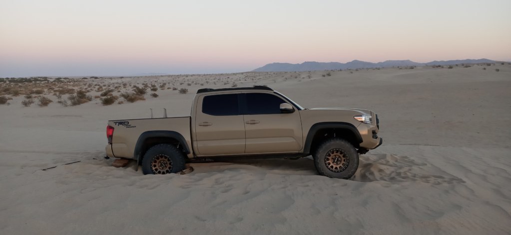

    1. Air down to 12 psi. Some ORV parks such as Silver Lake have written rules prohibiting tire pressures higher than 15 psi (i.e. they don't want you bogging down in the sand and needing a rescue). This makes the single biggest difference in floatation.
    2. Use 4low with rear locker. Make sure brake-based traction aids are turned off. Keep the shifter in S2 to prevent the transmission from upshifting and losing power. Redline as needed to spin the tires. With the KDMax tune I'm often pushing past redline to 7200 rpm doing dune climbs:

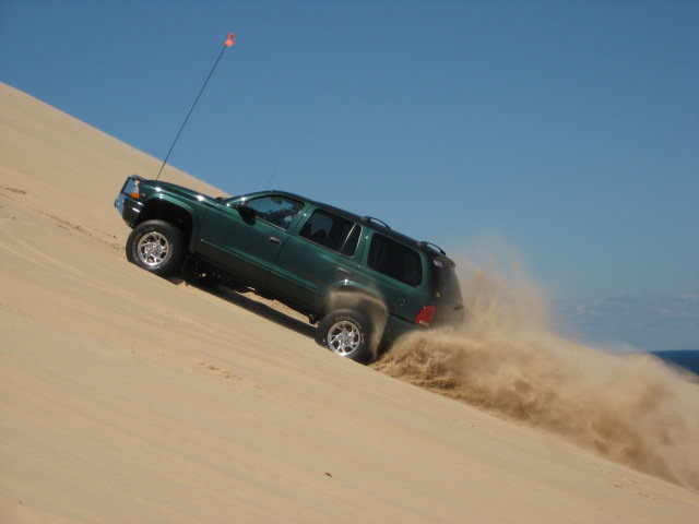

    Air down BEFORE you get stuck. That is why a good compressor is needed, without one a person is reluctant to do so and once you are stuck, lowering air pressure just lets the body sink closer to the ground. Also, different tires spread at different pressures, a stiff sidewall will need less pressure in it VS one with a more pliable one.
    I used to run 12 PSI in the front and 10 in the rear. I never rolled a bead. My old tubed Armstrong Tru Tracs I'd run 6 in the rear and maybe 8 in the front on a FJ40. I'm just running in 2wd in the pic.

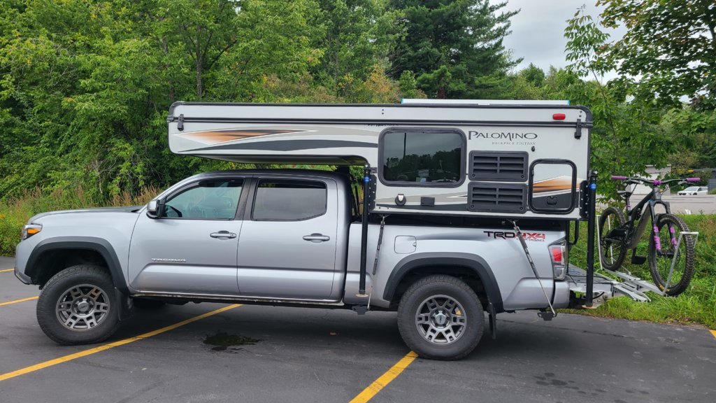

    Not sand but CC got me out of door jam deep snow with the slide-in on the truck.20240831_124939.jpg

    Sweet pic
