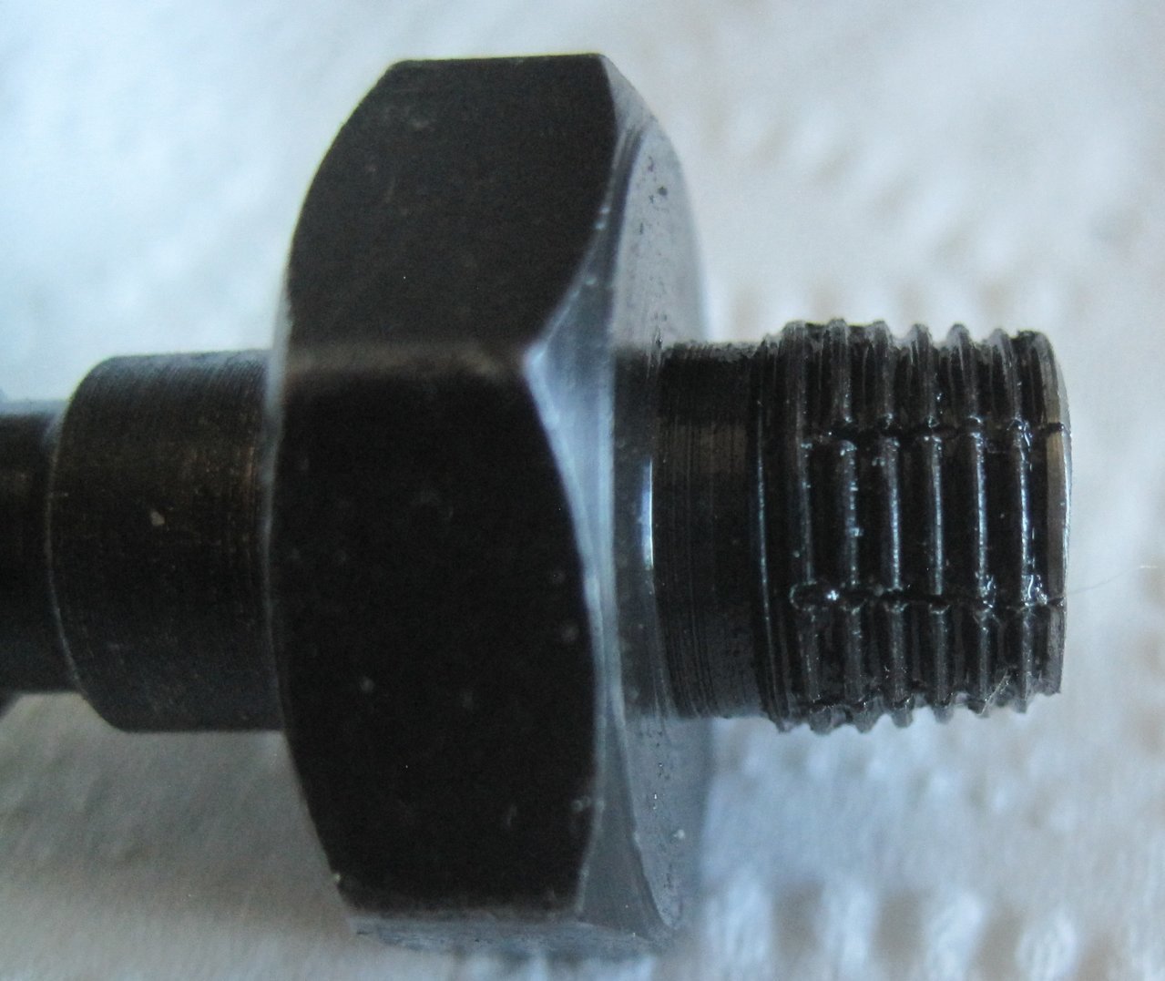

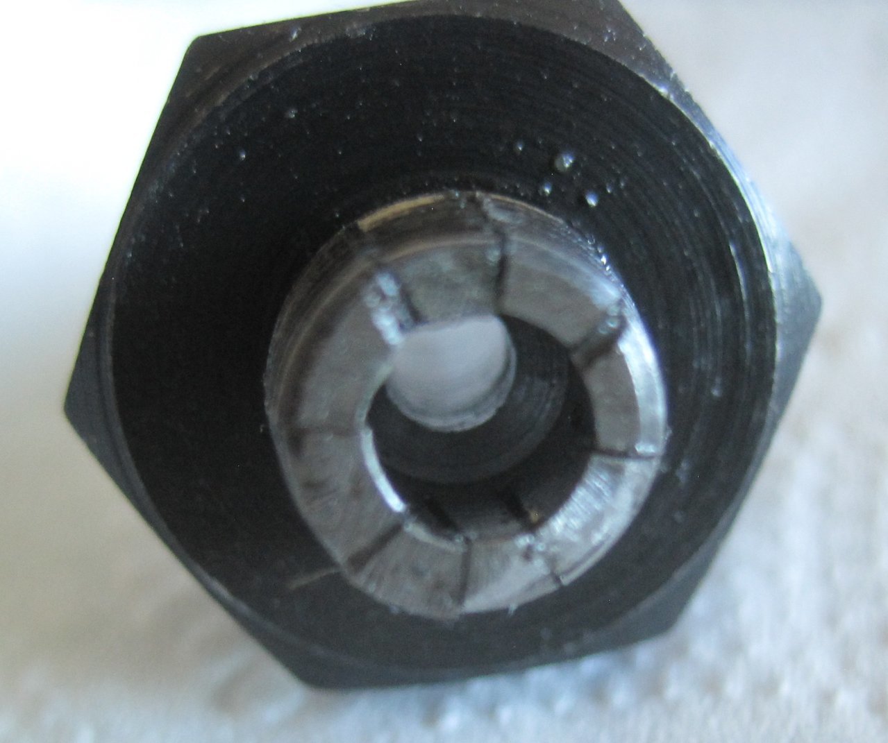

    I finally ended up with this solution:
    1) First I drilled out the hole bigger. This was to make the metal easier to bend later. I chucked this up on my small metal lathe which made this step easy. But you could also do this on a drill press.
    2) Then I purchased this narrow kerf hack saw. I had to look all over to find it. Using it I carefully hack sawed 4 slots across the top as you can see to provide releaf. Be careful not to saw too deeply, as you need to seal the oil in the threads that you don't cut. As it turned out I cut too deeply, and later had to resort to a O-ring at the base to do the sealing. This would only work short term on this hot engine area I think. .. unless you found a high temperature O-ring.
    3) Then I put the tip of the threads in an aluminum jawed vice and carefully squeezed the end of the threads, rotating a little at a time to generally taper the end. My adapter was a mild steel. Not sure how this will work on other parts.
    So once I was done with the modifications above, the once straight male threads would now easily screw into my tapered female hole.
    As it turned out my oil pressure on my newly re-manufactured engine was very good, even above factory specs. I suspect that in time it will come down a little as the engine breaks in.
    Hope this helps you. Good luck. At least if you screw up the first time you can try again with a new sender. Tapping out the engine hole was not something I decided I wanted to do, as it wouldn't allow me to back up if something didn't work and I got stuck.

    @Old_Truck
    That is really an elegant solution but More then I had time for.
    Turns out that O'Rileys stocks an adaptor that turns this thread into NPT and I just went that way.
    Thanks for your explicit photos and help. I sincerely appreciate it!
