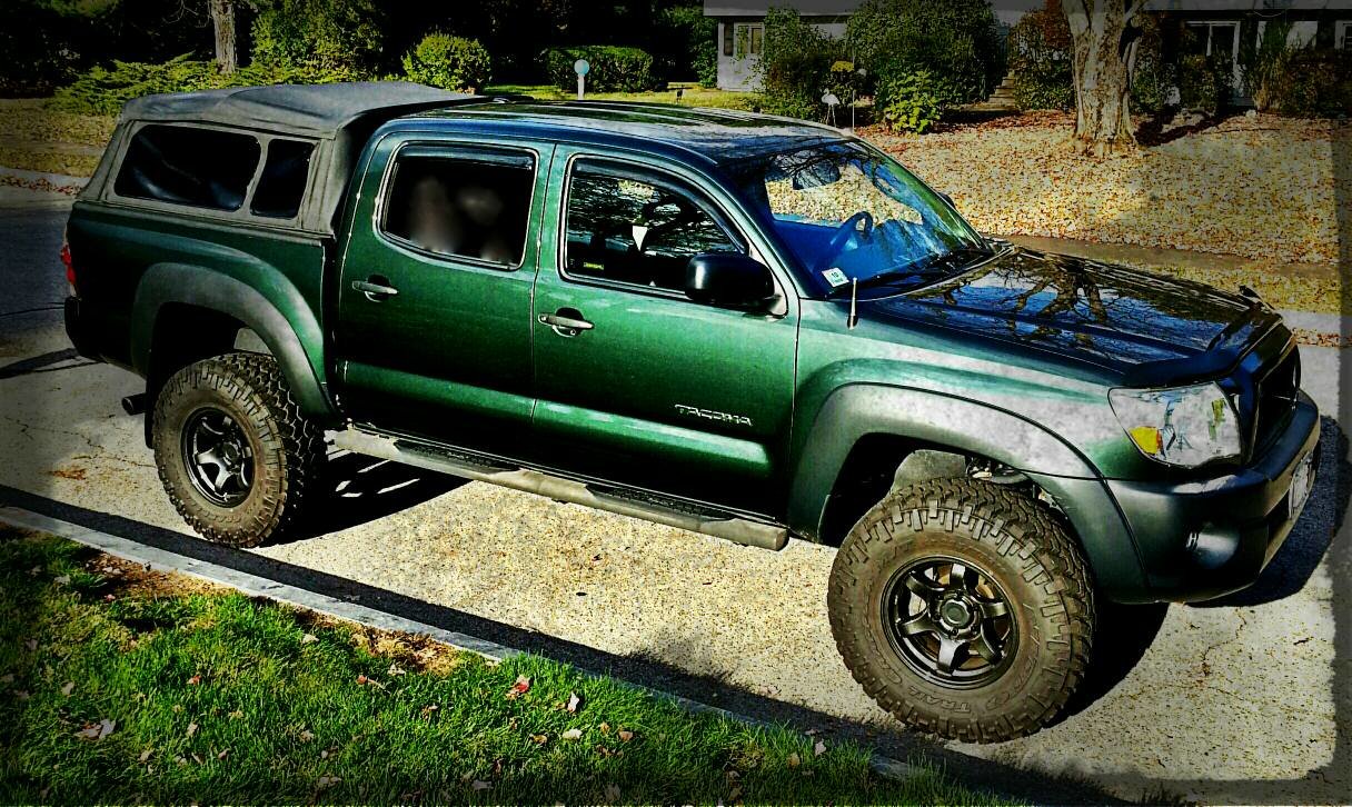

    Ready lift 3 inch front and back, skid plate, rims and tires
    Just curious to see what people have to say.
    I put this kit on my 2013 taco. Lift specs say it can fit 33-11.50 tire max.when I had it installed the techs said there is no way I could get 33s to fit. So I went with 265s.
    Wondering what other people are running if they have this kit. Also wondering if you think I could fit nitto mud grapplers 33-12.50/17 with wheel spacers.
    Any suggestions?
