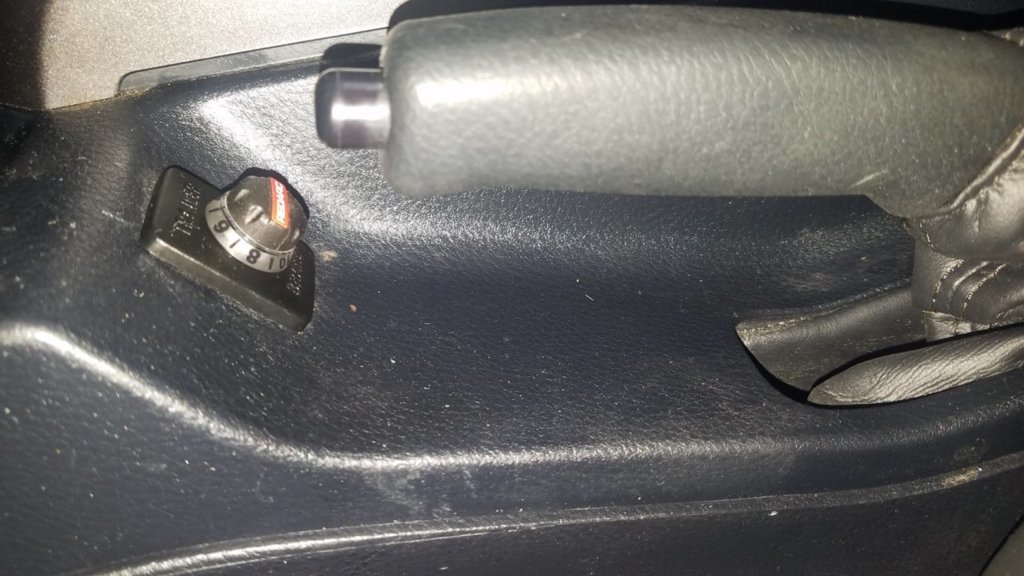

    Just make sure you get a trailer brake controller installed before you tow with the Tacoma. The RedArc towpro liberty is a good option if you don't have one installed yet.

    If you look up the unit you will see that when you install it the only part that will show in the dash is a knob/switch thing that will fit in one of the switch blanks in your dash. I will look almost factory installed unlike the Tekonsha controller that hang off the lower dash for you to bang your knee on.

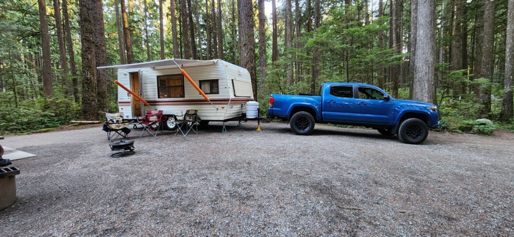

    I support the fibreglass unit RV for longer term occupation. You will deal with less water issues. As for wood units, I personally hate the construction of modern units. They seem so cheaply thrown together.
    I personally have an older '88 Fleerwood Prowler Lynx that is 17 foot and 19' 8" bumper to hitch. ( I prefer older tandem axle trailers ) It is 3800lbs unloaded and 4200 loaded. I have a Redarc Tow-Pro Elite brake controller. I haven't towed with a load distribution hitch yet but I picked one up and will get it on this year.
    I easly towed up into the Cariboo of B.C. and then down the Duffy Lake Road to Whistler, which has a 5 kms over 10% grade stretch.
