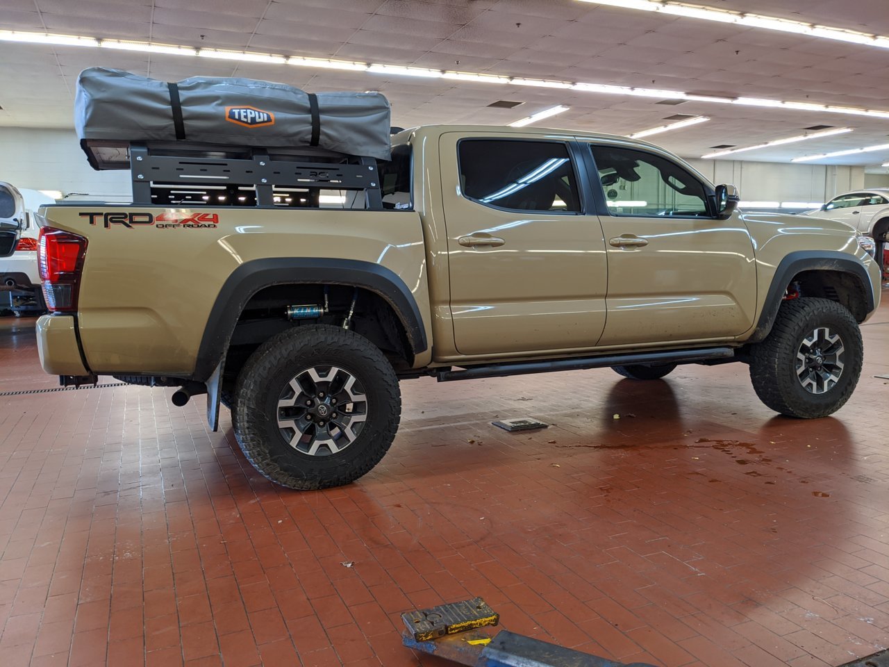

    I would do UCA's regardless.. Especially if you're going to go larger than a 265/75. Do you plan on wheeling it? Or do you haul stuff at all? I hate the idea of blocks personally for the rear. I would suggest a good quality leaf pack, or at least an add-a-leaf if you don't want to spend the coin.. The stock leafs are garbage.
    Are you dead set on 3"? You may want bigger tires as it might look "off" with those 265's. Here's my truck, which is right around 2-2.5"of lift and stock OR wheels (with 1.25" spacers and 265/75/16):
    I bought different wheels and 285's not too long after lol

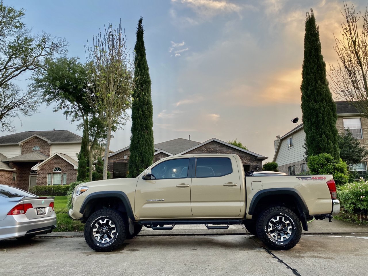

    I ended up pulling the trigger on the lift couldn’t be more satisfied with it

    Looks good how’s your alignment on 3” without control arms?

    It’s actually pretty amazing feels smooth like butter and Drives straight. Actually feels way better then before when it was stock height
