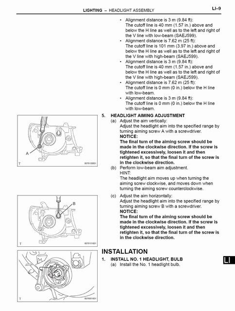

    I tried to find with a search and did not find anything,
    how do you reaim the headlights -

    hope this helps

    thanks !
