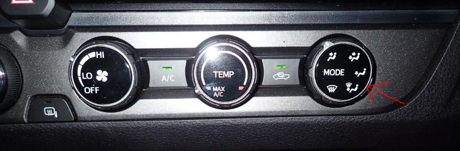

    I don't have a picture on it right now, but on my TRD Off Road with the basic climate controls, the fan position selector switch "clicks in" between actual selectable positions. For example, the "selected" position can be left between the floor/defroster setting and the regular floor setting. Why is that? Seems like a dumb design to me. What is actually selected when in this position?? Only noticed it because my windows weren't defogging the other night. Realized that my selector was between positions and my defroster wasn't actually on.
    Not my picture. Example position pointed to with red arrow.

    Funny enough I actually use those positions and I could've sworn my defroster works. This is how I see it and I'm sure I am incorrect in this thinking but I look at them as a percentage. So in your example, I would see it as like 75% footwell and 25% defroster. When on the next click it would be 50/50. I'm usually in the click between full defrost and footwell/defrost, so maybe that is why my defroster still works? idk...

    Usually, it's cold out when you need to defrost your windshield... so you also want hot air to heat up the cabin. Since heat rises, that's why you have that option.

    That is 100% not dumb for me. The position that you show and the two notches to the left are the ones that I use most all of the time.
    I am trying to not go on an OT rant about not having full control of A/C when using the three remaining notches to the right.
    It is not the best description, but I translate it to say that they are just giving you more adjustability than shown by the symbols. As I said above, the in betweens are my main selections.

    Yes. That in between notch is the last one that will not automatically engage the A/C. The remaining three to the right force A/C to be on.
    One note on highway experimentation. On my end, that in between position works better on the highway than it does on slower side roads. I'm assuming there is some cowl induction effect sending more air in.

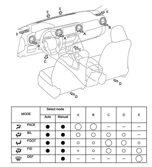

    Oh! While I do agree that there is such a thing as a dumb question, I don't think yours was dumb.
    BTW, this little diagram was helpful when getting used to the mixing of the controls:
    It is mainly for the ACC double cabs, but . . .
