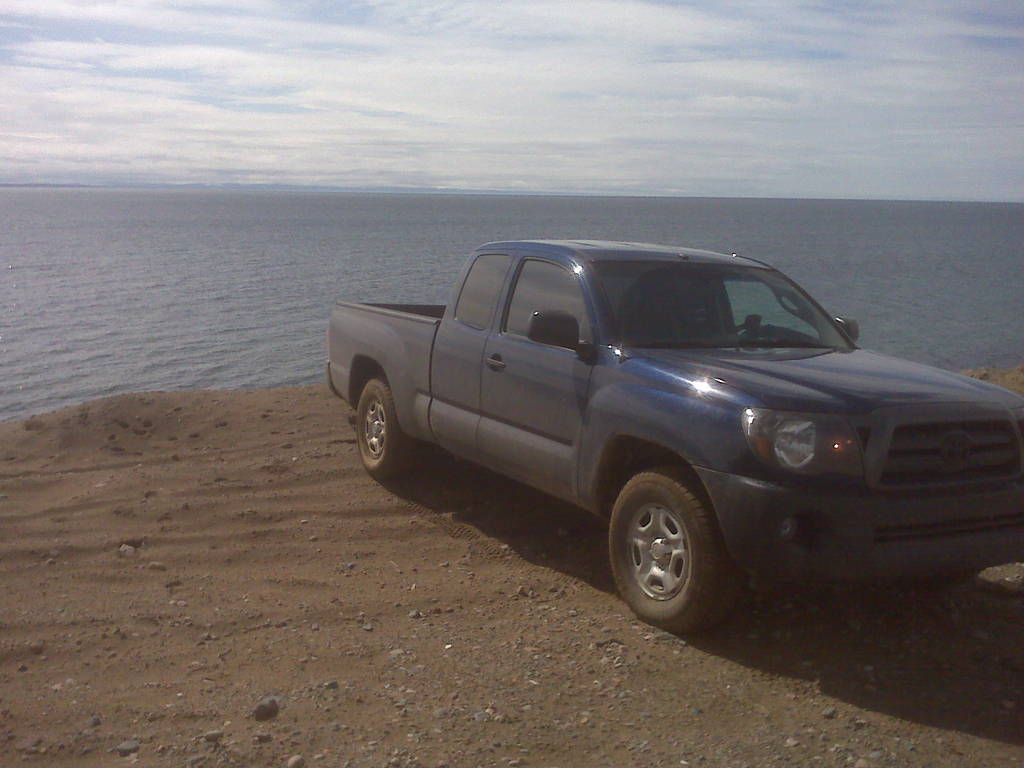

    and instead of making another beloved tire thread, can anyone with the 235/75/15 tires on a stock height 5 lugger post some reference pics? i have 225/75/15 winter tires now and am lookin at some toyo open country a/t's and am undecided about weather i should stick with the 225 or go up to 235
    thanks
    here is what the 225/75/15 winter tires look like on stock height. sorry for the bad pic but its the best i got, but there is a couple other views in my gallery

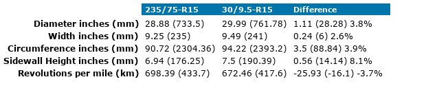

    You could run these or go with 30x9.5R15s on stock wheels.
    from the online tire size calculator
    No need to re-gear. You could do some other MODs to compensate for lost power -> remove secondary air filter and install an aftermarket drop in air filter.

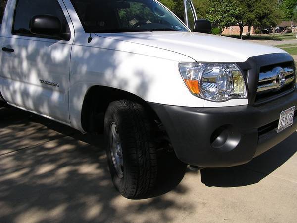

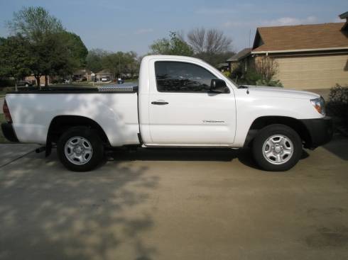

    Here ya go Cars0n, fresh off the rack:
    (the bottom is the before shot for comparison)
