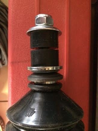

    Think this is right.

    You need to flip the black one the other way ,then the bushing. The black one will cup the bushing. Then silver on top of bushing...I think one of the silver has a little collar on the top of it that goes into the hole on the frame. Then the frame, then bushing, then last silver facing down cupping the bushing, then the nut.

    Just checked mine and the black is on top. So it goes from bottom.. Silver, bushing, silver, frame, bushing, black, nut. Sorry for the confusion...just trying to help.
