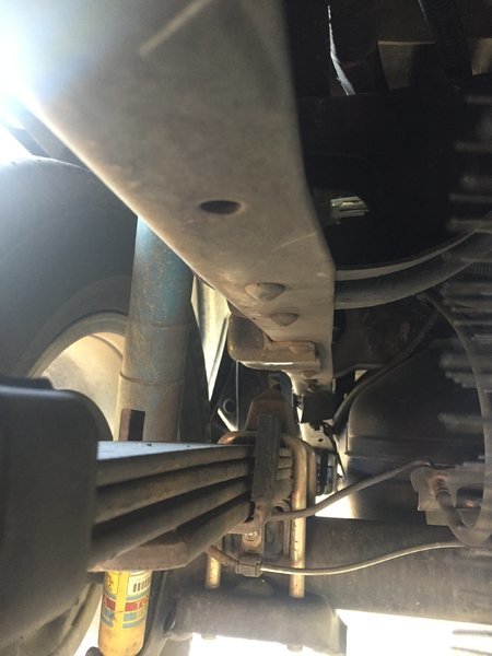

    I have the frame on jack stands & the axle on the jack. This is the position of the axle hanging from the leaf's.
    I'm going to have to jack the axle up to get the bag's attached, this leads me to thinking that without a axle strap to limit it's downward movement, the axle, tire's & wheels will all be hanging off the bags. I'm subject to a little twisting off road, but no wild "wheeling" but don't want to worry every time I might go through a little off camber twist about ripping my new bag's apart. Do these Daystar cradles leave the bottom side "unattached" or have something else for this concern?
    edit; I just found them online and got my answer, but also found a review where a guy had them not "re-seat" properly and ruined a tire and a bag! Also came across a Firestone notice that mentioned Daystar by name and that they were not compatible and would not warranty the bag's with their use.

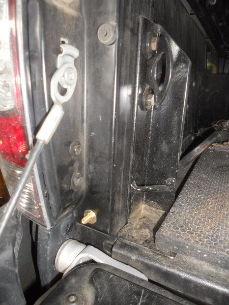

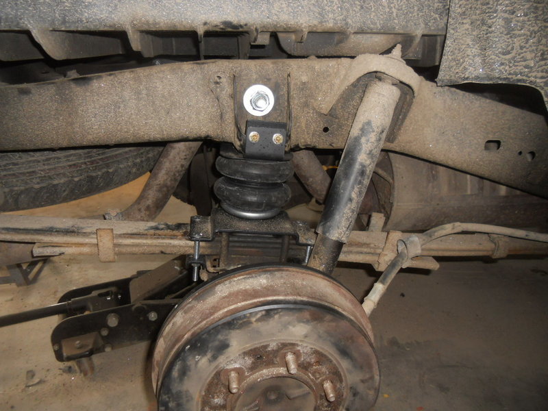

    All done, not much to see but there on, simple installation. I routed the air to the corners at the tailgate side. Should be put of the way there. I forget who mentioned he's never needed more than 10 psi, he wasn't kidding. It's hard to only put 10# in! I have not loaded it yet.DSCN8683.jpg
    After I was finished I read the instructionso_O (there are good diagrams) and it stated that they were designed to support the axle while up on a lift, you just need to empty the air.
    DSCN8685.jpg the right side is the same location.
    I bought a 0-20 air gauge to keep in the truck. Good and service from "Parts geek.com" and under $300.
